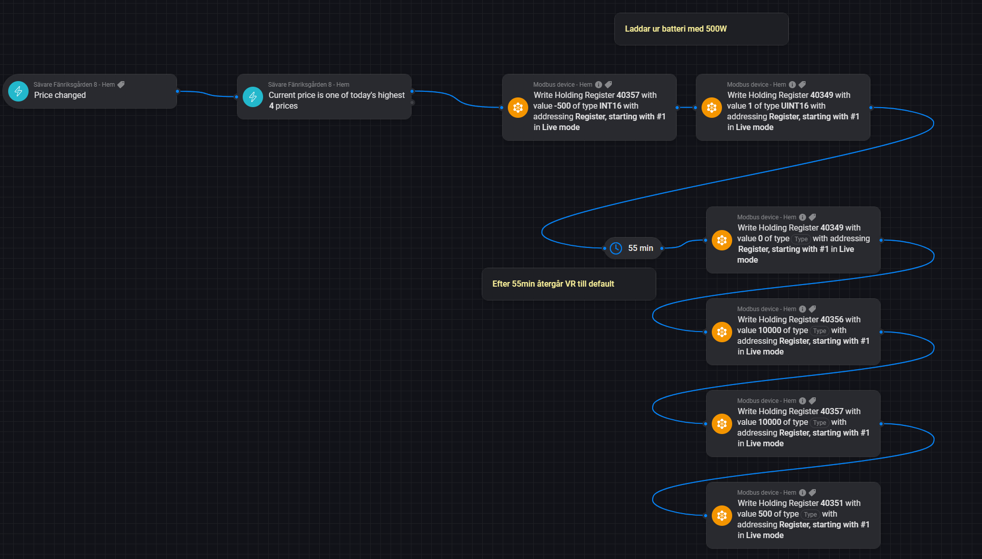

I cant make my fronius to force discharge my battery, i cant find witch register to use. Have you made any flows there you discharge your battery for example during expensive hours?
Im to dumb for this, i cant find the register, i cant make the battery to discharge when the price is high either.
Hi, here is an example (sorry, only german):
Thsi flow can be started from another one (Input trigger) providing the target value.
Or you can start directly/manually with the fixed value used from the play button.
Some examples how to use Fronius registers to charge/discharge can be found in this HomeAssistant description.
Fronius and BYD battery control via Modbus
Thanks again for helping me learn. What type is used for register 40356? Instead of setting % i want to set a fixed Watt. i have followed your flow above
You can only set a percentage of max. charge/discharge power that is defined in technical inverter settings:
10000 = 100% because Fronius uses INT+SF values for Modbus/TCP. That means for percentage values, a factor 100 is used to pass INT values instead of float values via Modbus API.
The type is INT16 for 40357. I used the wrong register for the input trigger. I exchanged the screenshot in the last post.
Thanks. That was very helpful, i have tried this out and now i can discharge my battery at for example the 4 most expensive hours.
