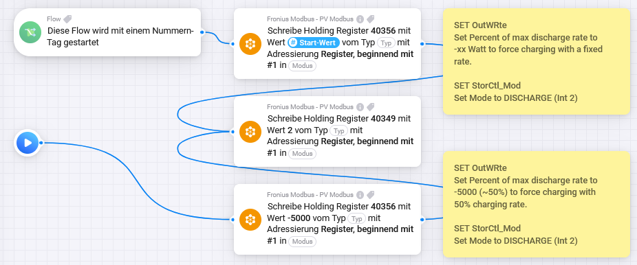

Fronius list:
Example 2: Set charge power
You can set the charge power to a ampere value. The battery is charged with this power until you reset the register to default values.
Disadvantage: The battery will be charged independet of previous state. If you still have 50% SoC and want only to charge to 70%, you have to calculate by yourself, how many ampere and how long you need to charge.
Fronius list:
Flow:
This flow can be started with a variable or directly (start button) with a preset power.
-5000 means -50%: The battery is forced to charged with 50% of max charge power.

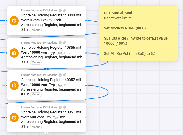

To stop forced chargin, reset the registers to the default.
The last card sets min SoC to 5%

In this case, the example 2 should work. You have to try a bit with the value. If you have 10kW max set in your inverter, you can set -2000 (=20% of 10kW) to charge with 2kW.

Battery charges to max SoC. I also think it charges to the max SoC you set in Fronius inverter settings. And will keep this limit until you reset the registers. If you have some energy usage, it will also use energy from grid as the battery is forced to charge and won’t allow discharging during this period
Thanks, i made a flow that checks SOC every 20min, if its >80% it reset registers.
And a flow that charge the battery four of the chespest hours with 2000W. But only if the SOC is <80%.
So the cheapest hours charging and stops after 55min or SOC >80% that updates every 20min.
