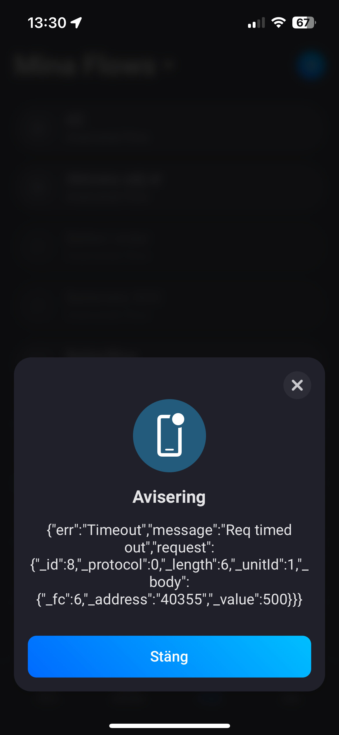

I have error in my flow that worked for a while
Looks like a request timeout sending a value. Is the device online?
If you have other Clients connecting to the device (manufacturers mobile app, cloud service), it’s possible that a parallel request is not possible.
Easiest way is to use the flow card error output and try a second request after 1sec.
I did a restart of my routers. It works now :sweat_smile:. Thanks for the fast answer

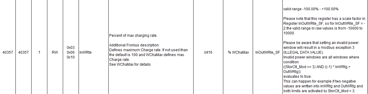

Is it possible to set a max charge rate, if i want to export part of my PV-power to grid
There is an example on my Blog:
See header line “charge limitation to delay PV charging”
You can set charge limit to “0”. Then all goes into the grid and not into the battery.
First flow can set the charge limit (% of max), flow 2 resets the limit to default (100%).
Percentage is used as integer. 10000 means 100%
