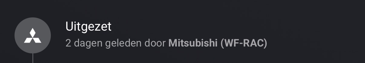

Thanks for continuing to develop this app, @evdpol ! It’s great that energy values now seem supported. However, my ACs, which have been off for some days now, continue to report the same daily energy kWh value every single day, sometimes using even more than my entire home did that day in top consumers. Might this be a bug in the app where the daily energy usage doesn’t reset, or something like that?
You mean: like this???
Top Consumer report of today.
Both aren’t used today.
