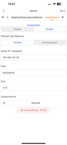

sorry for asking another question!
Upload Interval : 16 sec.
this value indicates how many seconds are the values ​​on the app and on Homey updated?
can i decrease and increase?
Thk
Sort of correct, but it is determined by the device as it pushes data to Homey.
Some devices update faster than others and Homey only shows the time since the value changed. So, if say the temperature is stable, then Homey might show it has been minutes since it updated.
Hope that makes sense.
OK, you can’t go below 16 seconds
