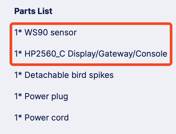

I am looking to buy the ecowitt wittboy (maybe the pro) weather station and I hope to be able to use Adrian’s app with my Homey Pro. The worry I have is that I can’t specifically see that it is compatible.
I am looking at this unit: HP2564 Wittboy Pro 7'' TFT Full-colour Touch Button Display with 7-in-
Do I need to buy an additional gateway or anything else do you think? Or is that connectivity supplied via / as part of the display screen?
If anyone knows or has this unit I would be very grateful to hear from you. Thanks in advance.
In this topic it’s already several times mentioned, that the Ecowitt Wittboy (WS90) is supported by Adrian’s app. But you’re right, it would be much be clearer, if it’s mentioned in the app store. It would also be clearer if the WS90 were listed as a separate device while adding the weather station via you app, @Adrian_Rockall?
Acc. the “Part List” and the confusing table on the Ecowitt website, in the display HP2560 is the gateway included, so no extra gateway is needed:
Afaik, there is no Wittboy Pro available. I guess it’s named Wittboy Pro because of the bundle with the display screen, Acc. the “Part List” it’s also just the WS90 sensor.
Please check the needed frequency for your region before purchasing.
Thanks Dirk! You are quite right, the WS90 is mentioned several times in this extensive post; thanks for pointing out that the ecowitt parts list shows WS90 also, that’s the bit I missed, my bad.
Yes I’ll be sure to get the Oceania / 433 version (Australia), thanks again.
