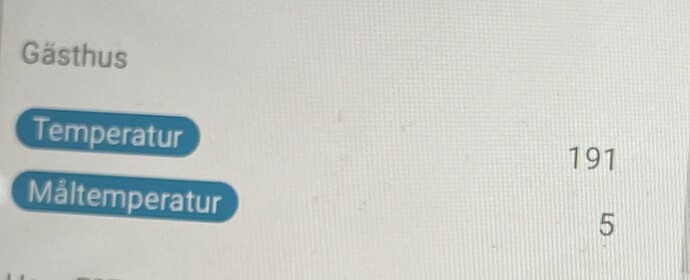

Current temperature is 100x what it should be. Currently showing 191 instead of 1.91.
