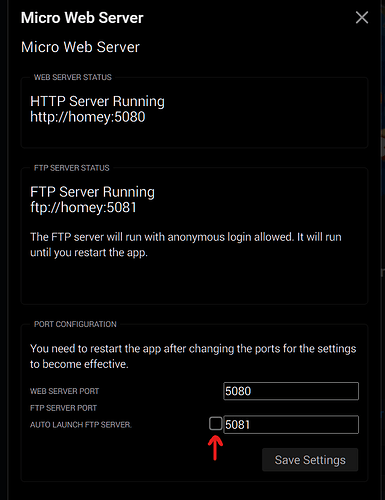

Hi! My ftp goes offline after a few days so my flows fail. How can I turn on ftp automatically?
I tried restarting the app but it doesn’t work, it doesn’t auto-start
Did you actually enable autostart for the FTP? Because the default is no autostart. That is a checkbox in the app settings.
Aaaaaaaah, is this?
Sorry I didn’t see it, Thank you!
yes. ell the page is a little glitched, not sure why :smiley:
