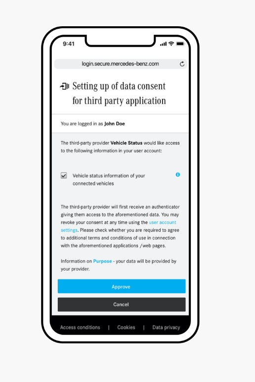

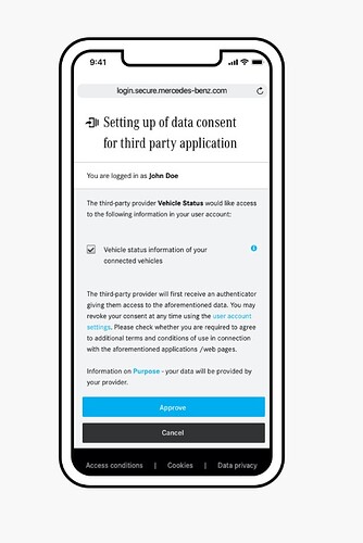

I have found in the instructions this image that I attached. I think that is what he is referring to.
The problem is that I don’t know where to find that web page to authorize third parties.
According to the instructions it says:
authorization
Exchange your credentials for an access token within the OAuth process and give consent to access data from your car.
Note: The Mercedes me ID you enter here must be the same you used to log in to the Mercedes-Benz /developers portal.

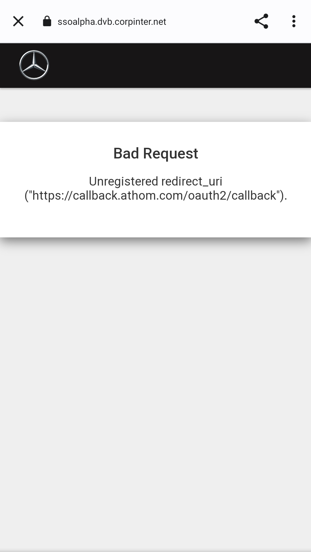

Hello.
Now when the app tries to identify itself, I get this new warning. Sorry for so many answers.
And thanks again for your help.
The app uses OAUTH2 and the URL is required for the OAUTH2 call back.
The credentials you create on the Mercedes website are used for the token and secret parts of the OAUTH2 protocol. These are passed on to the Mercedes login page and used to validate you. Providing everything is good, an access token and refresh token are returned via the callback. The access token is used during each API call and the refresh token is used to get a new pair of tokens when the access token expires.

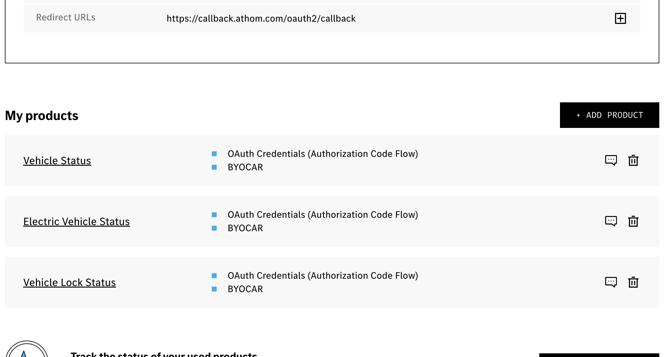

Can you confirm you have setup the project like this:
Yes, looks like that. Shorter list, but that should not matter?
