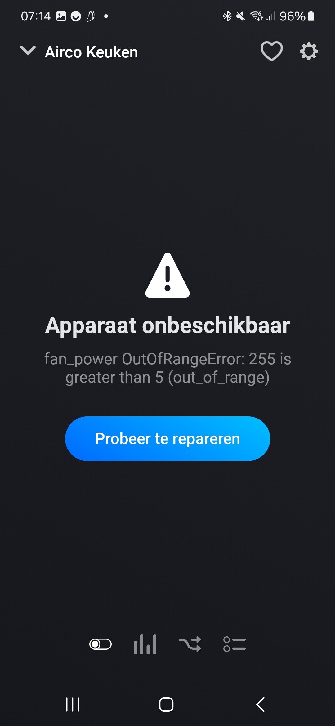

I got the following error. Rebooting homey or repairing device won’t help.
Hi @Witteflits, this issue is not directly related to the app, but to the last Homey 2016-2019’s firmware.
I’ll try to find a clean workaround, in the meanwhile can you please contact me on Slack https://slack.athom.com/ so I can check something?
Thanks for your comment. The latest version was installed last night. Yesterday I had no problems.
Yes, but last night’s release does not deal with your issue. I think it’s just a coincidence with last Homey’s firmware. If you go on https://slack.athom.com/ we can confirm and try to find out the best workaround

Hi @OlivierZal, after the last update (33.0.1) I got this error on my heat pump:
Do any changes made which can cause this issue?
Thank you
I’ll investigate.
