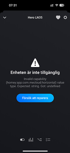

Hi, this morning I have this message in the app;
I have tried to fix the app without luck.
3dfc0075-fe54-4d69-b75f-080ee5f08265
Hi @KWallin, I’ll investigate and keep you informed.

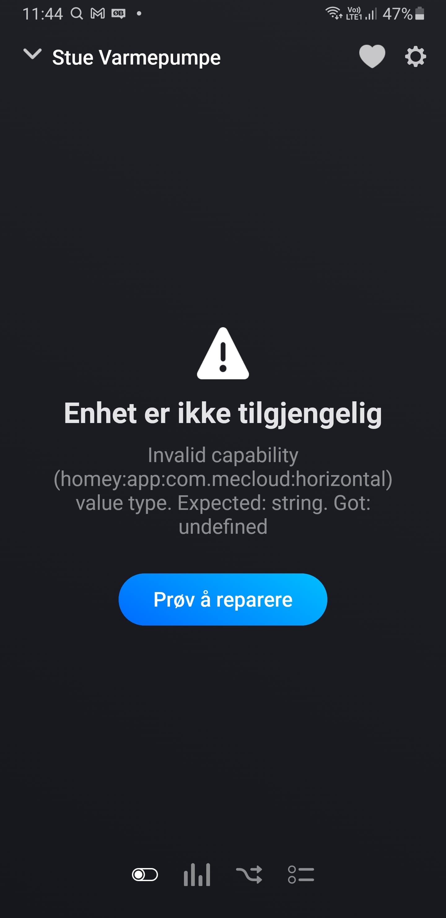

Hi, I got the exact same message as @KWallin

Hi @Dag_Gulbrandsrud
@KWallin’s issue is that its horizontal mode is “wide”, what the code does not take into account.
The fix is in progress: do you confirm you have “horizontal” in your error message? otherwise the issue is different and I will need a screenshot and/or diagnostic logs from your Homey.
Hi ! Yes - same message !
And your absolutely right - changing horizontal mode makes the app functional again. Looking forward to the fix ! Thank’s s lot
