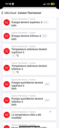

Iâm not able to find it. For the indoor temperature, there is a When temperature changes-card, but I canât find a similar card for the outdoor temperature
I think that because of some bug on Homey side (not MELCloud app), the trigger card can appear / disappear, but if you try again and again, the card will show up.
In French, outdoor temperature = température extérieure
So if I understand the screen dump correctly, there is one card for if the temperature is above some limit (devient supérieur à ) and one for if the temperature is below some limit (devient inférieur à ), but no card for if the temperature just changes.

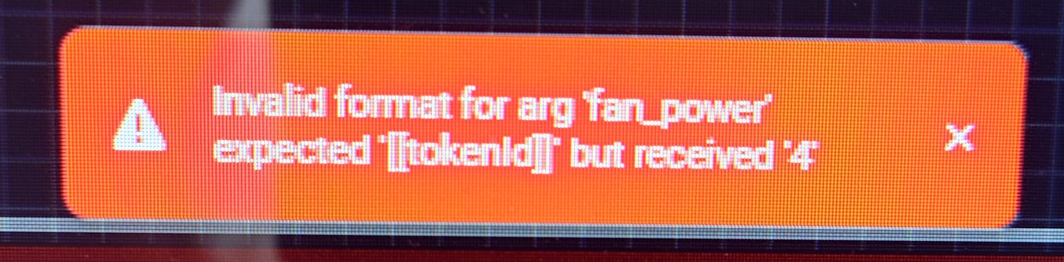

Hi, I noticed that Iâm not able to save changes to my flow due to the card âset fan speed to xxâ. I get error message âInvalid format for argâ fan power" exoected âtokenidâ but received â4â. The option for fan speed is a slider from 0-5.
I tried to replace the card but still same error message comes when I try to save the changes. Easy fix?
Hi @Yankie, anyone who encountered this issue solved it not only by replacing but by removing / recreating the cards. Can you please try again?
Thanks @OlivierZal , that worked.
