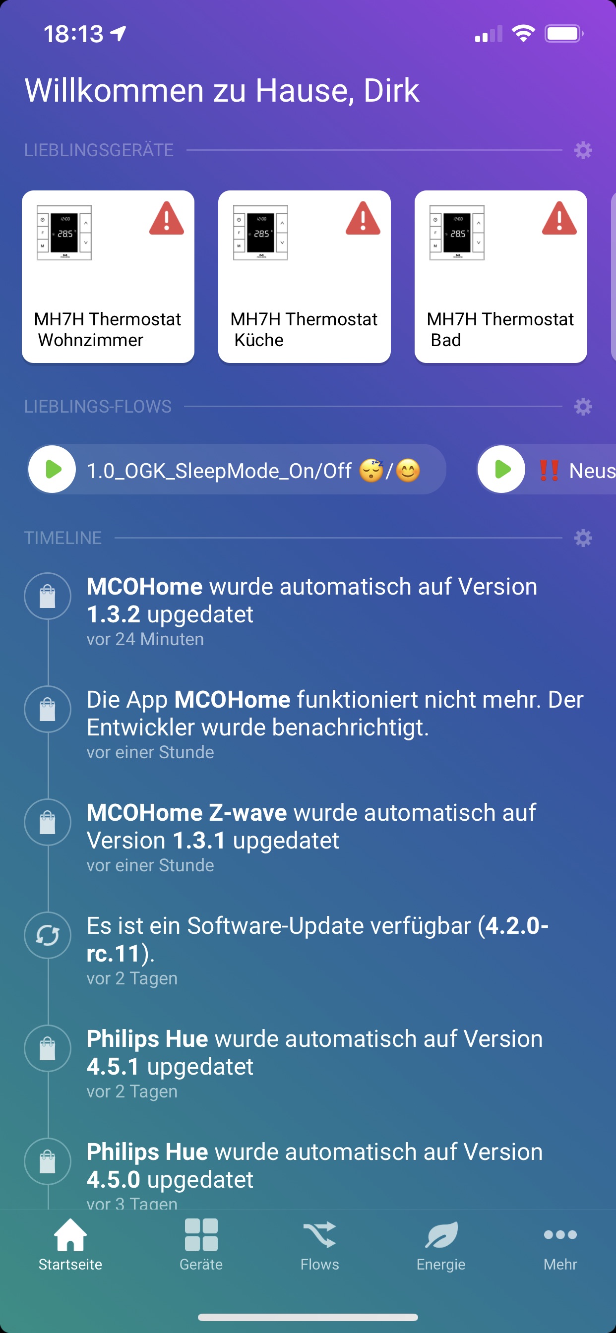

Hello @TedTolboom!
after today’s updates 1.3.1 and 1.3.2 my MCO Home MH7 thermostats are no longer accessible. Restarting the app could not solve the problem.
Hi @DirkG apologies for the inconvenience; with the update to 1.3.x, an error was made in the MH7 driver that should not have been made.
Can you indicate what the error message is?
Can you restart your Homey?
That should solve the non-availability of your thermostats. If not, please send me a diagnostics log from the app.

No, I can’t specify the error, sorry. The devices were just unreachable.
A Homey restart seems to have solved the problem, now I have full access to the devices again.

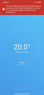

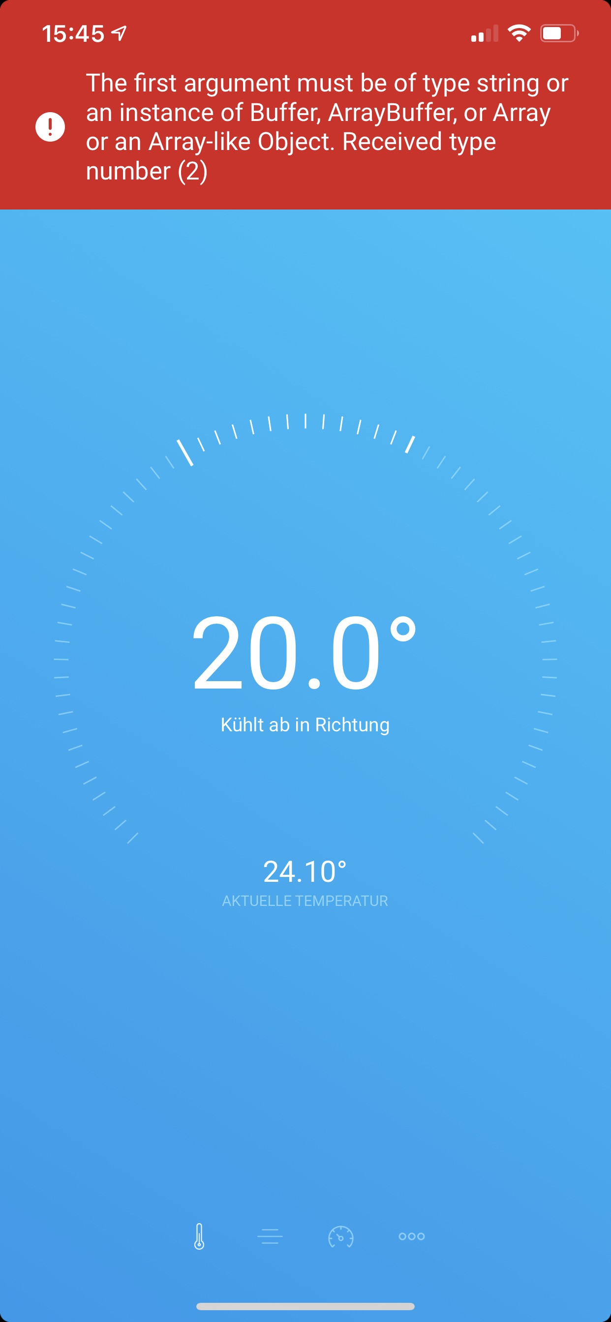

Hi , thanks for all the great work. But since the last update my MH7 thermostat doesn’t work anymore. It is reachable but when i change the temperature --> “value” argument must not be a number == is the error that i get, restarted the app first, after that Homey but still the same result
I can confirm that error. Yesterday I didn’t try to change the temperature.
I sent you a diagnostic report: 241a2366-a1c8-4b0b-9040-9f9dd036c30f
But since the last update my MH7 thermostat doesn’t work anymore. It is reachable but when i change the temperature → “value” argument must not be a number
Thanks for reporting. Should be corrected with version 1.3.3, which I just uploaded to the app store:

Manual setting of temperature and mode is now possible without errors.
Many thanks for the fast support!
Thanks again! I’ll keep you posted as soon as the update came true
edit: everything works like a charm again now, many thanks!
