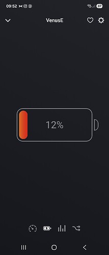

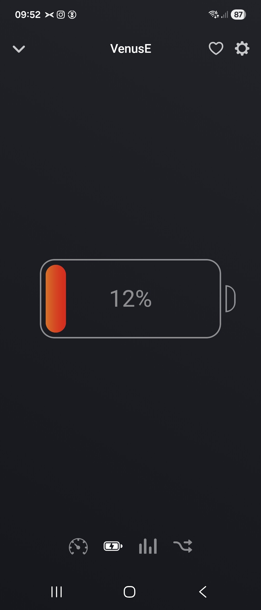

I only see this. The status is always - other variables are not really updating. The opgeladen (net) and ontladen (net) vakues keel the same even when its a new battery and installed it for the first time. In the energy tab it keeps saying 0wh on charging and discharging. Not animation. Only the battery percentage is working fine.
Marstek firmware 147
Communicationmodule is still 2024
I had to update the communication module to 2025
Only i still don’t see the oplaadstatus
