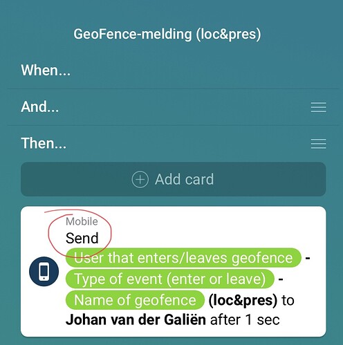

Used L&P some 2years, but had to redo everything in a new house. Now IHave a weird problem.
Some flows are working, others don’t. It made me crazy, because it was al working before. After a close look I see something weird in flows.
this one works:
This one doesn’t:
The first one is an “old” flow. See the difference ; the “>” character!!!
Every time I make a new flow this “>” character isn’t inserted in the text of the flow and the flow doesn’t work. When I copy the old flow and change the users phone the character stays in the flow and it works.
Looks like I can’t create totally new flows that work.
Anyone a suggestion what is wrong here?
