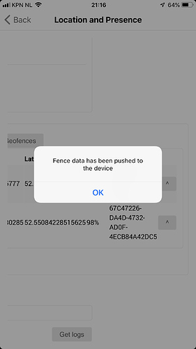

How can I sync those on an iPhone? The screenshot from Android show an advanced setting, on the iPhone I don’t see something that publishes my ‘home’ geofence to other phones. The homey knows about it, the phone that configured it knows about it, but the second phone does not show this geofence. Can I push it from the 1st phone or homey app? Force get it on the second phone?
Ah you want to push to other phones? Go to the settings page of the homey app.
In the overview tab you will see the most actual data of the knows users. At the right side you wil see a button that says ^ by each line. Press it and it will send the data of the geofences to that phone (only MQTT for now)
Ah! Thanks. That phone is en route now, so I will have to wait for a check if the app is showing the fence. This is the screen scanno is talking about:
If it does not show, the device has to accept remote commands. Its a setting somewhere on the phone app.
Only on Android under Advanced. This option is not available on the iPhone.
Nope. Did not work. I see the cmd command in the communication but the owntracks app on phone 2 does not add the geofence. I clicked the arrow next to phone two since that is the phone that needs the waypoints. As a quick fix I exported the waypoint in my settings screen and send them with airdrop to phone number 2. If it can not be send as it should, then we should send it as it can… Let’s find out if this exported geofence is triggering flows…

Doing some major rework on the Location and Presence app. Just managed to get pushing of waypoints working on https connections.
Pushing of waypoints means that you can send all known geofences from the Homey app to a known phone.
That was already possible for MQTT users, but the internal rework makes it possible to store messages to https connected phones. Once a location change comes in from that phone, the geofences are send inside the https response.
In the Athom Homey app, go to the App section, choose Location and Presence. In that screen press Configure App.
Then you will see the Homey Location and Presence settings screen. At the end of the settings screen, select the button/tab users. There you can add the new user.
