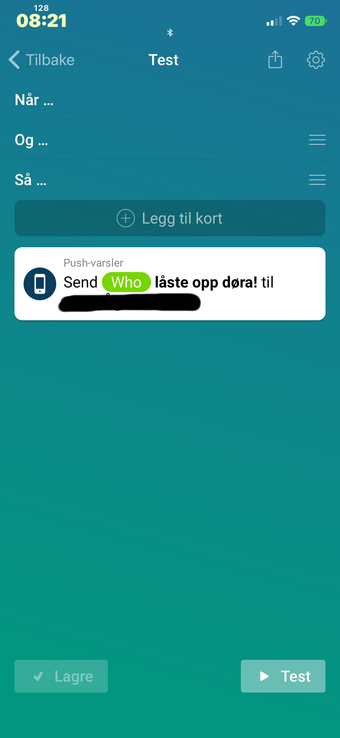

Hi. Thanks for this great app! I just installed two id locks at my house and overall I’m very happy with them. I’m however unsuccessful in creating a flow that pushes a message with who unlocked the door. Please look at the attached screenshots of my flow. What am I doing wrong?
I don’t know if there is any truth, but someone said it only worked for him if key1 and tag1 were set to same name (and so on for 2, 3…)

How can i find the ID og WHO?
Read the posts from Teddy, starting here: https://community.homey.app/t/id-lock-app-v1-2-2/161/171?u=ja.nei.johan
