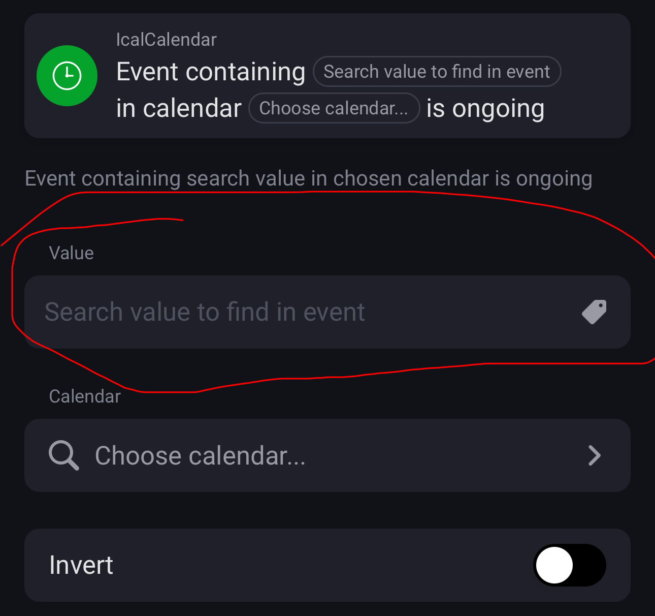

This card will be true if the calendar in question has an ongoing event where the title of the ongoing event contains the given match phrase.
So if there’s an event in calendar Vakantie where the title of the event contains Vakantie Atilla then this card will be true.
Likewise, if there’s an event in calendar Vakantie where the title of the event contains Vakantie then this card will be true.
Vakantie will match for both Vakantie and Vakantie Atilla
The app searches for events containing the phrase you entered in the flow card
Is there a possibility to specify these phrases?
You specify the phrase in the flow card
