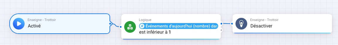

Hello. I’m trying to do a flow that deactivate a lamp if it’s activate on a day when a particular calendar has no event on this day.
I have make this simple flow :
The logic card check if the number of calendar events in this specific calendar today is below 1. Since there is one event today, the number of event today tag should be 1 but it gives me 0 and therefore the lamp deactivate when it shouldn’t. What am i missing?
The today tag shows number of events today which hasn’t started yet or are ongoing.
That should be my problem. Thank you for the fast answer. Anyway, i think it could be a great addition to this great app to be able to have tags that count the number of event which has already hapend today or yesterday. Thank you for the great work :smiley:
