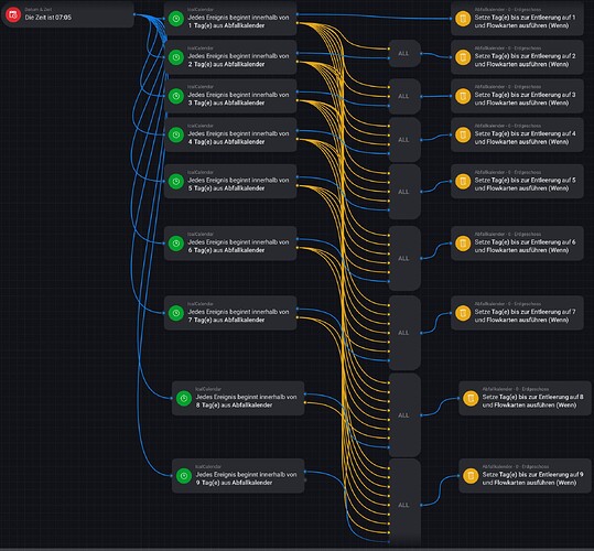

I also have a question. And as I don’t know anything about HomeyScript either, I don’t know whether it would be possible to do it with it, or in another way.
I would like to fetch the number of days until the next event in a calendar.
Does anyone have any ideas?
Btw, this is my actually workaround to check the next 9 days::
Not really nice, but it works. However, a more clearly structured flow would be nice.
