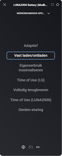

Good morning. I checked it in Homey and I don’t have an app that controls the battery for fixed charging or discharging. I also checked the Fusion Solar app and it is set to maximum self-consumption. Do you perhaps have another idea as to what might be causing this or where I can look? Once again, many thanks for this app and the assistance.
I have attached a photo of my app settings in the Huawei app. It is in Dutch (I am from Belgium myself). maximaal eigenverbruik means maximum self-consumption in English.
Thanks
Peter
