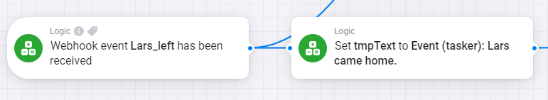

Homey Logic had http requests, like a few posts above:
I saw them, but they seem to be not working for me. But if you mention a unique thing in your flow, I am doing something wrong then.
IF: I use logic, webhook event received. Where I use “renzoaway” as event.
THEN: send push notification
I am using the url provided with the card (https://webhook.homey.app/*####*/renzoaway?tag=away)
When I past that in a browser I get the OK result, but a push notification isn’t sent.
