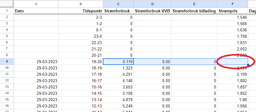

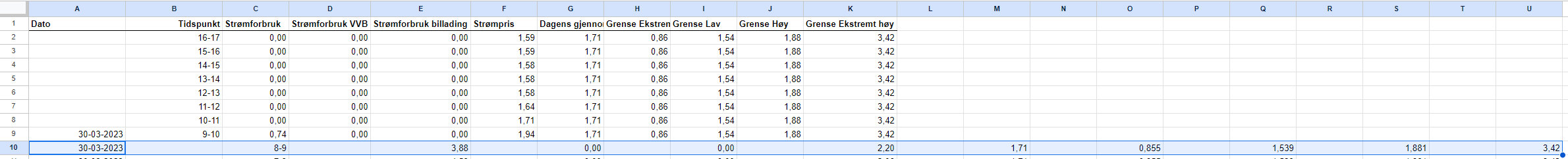

A new issue with v.1.7.1.
Can you look into this as well?
This
actioncard
results in this
Seems as its updating every other cell.
diagnostics report: a558f68a-644f-48c7-ad5d-99f2a8029a1a

@MHanaes
Hopefylly, now it’s ok
Grab v1.7.2 from here : Easy Logger | Homey
Everything running smoothly now! Thanks alot!
