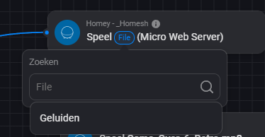

I have created a flowcard to play files on the Satellite, directly from the Micro Web Server app.
It lets you select a file and play it on Homeys (Satellites).
This way you can control the files on the Controller while playing it on the Satellite(s).
Also, it allows for files larger then 900Kb to be played. :slight_smile:
Play File
This currently works already, but i get the file lists through the FTP client, which means the Ftp Server from the Micro Web Server needs to be active while editing flows (autostart is available in MWS).
(The url that is used in the background is to the HTTP source, so the flows will work when ftp is down, just not the editing).
You can set the Ftp Port in the App Settings. Default is 5081 as is default by the Micro Web Server.
It’s on BitBucket: QlusterIT / nl.qluster-it.homeshcontroller — Bitbucket
