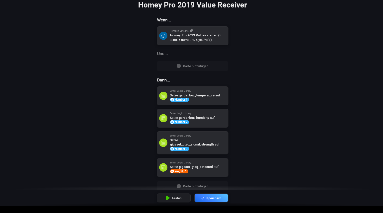

Tried it myself… Maybe others do find it useful.
So basically I also installed the Homesh controller app on my old Homey Pro 2019 and the satellite app on the new Homey Pro 2023. Before I only had it opposite because I actually just wanted to trigger LED ring and speakers with the new Homey Pro 2023. However you can also set it up bi-directional.
Reason is that only the controller app can call triggers on the satellite and I need to push values.
So I do have a 433 MHz temperature/humidity sensor attached to a garden box and a Gigaset bluetooth beacon. Both have limited range so I still had to connect them to the “old” Homey Pro 2019 being closer.
Then set up a regular update on the controller-side with the “real devices” where you send the values of all 4 readings (gardenbox_temperature, gardenbox_humidity and gigaset_gtag_signal_strength numbers and gigast_gtag_detected boolean) to some trigger on the other side, i.e. the new Homey Pro 2023 being the satellite.

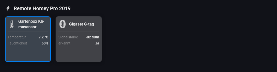

On the receiver side the values are stored in better logic variables. This way one can create advanced virtual devices on the Homey Pro 2023 reading those variables being the satellite in this case.
Voilá… Device clones of a remotely connected Homey Pro 2019 on my master Homey Pro 2023.
Quite some effort and not as elegant if it would come out-of-the-box (btw: an bi-directional Homesh app would be cool, too), but doable.
Have fun, Michael

Thanks for the hint that one can skip the BL variables. Didn’t know that flow card. That’s easier. :slight_smile:
For the event-driven updates your right. That would be better. Unfortunately at least the Beacon app has no event for signal strength changes, just beacon inside/outside/changed, so I might stick with the timer and probably just extract the climate sensors. As I don’t have advanced flows for Homey Pro 2019 bulk updates might less work anyhow as one can send up to 10 values per type. At least as long as there’s no need for immediate updates or the timer executes too often. So probably depends what works best for each use case.
