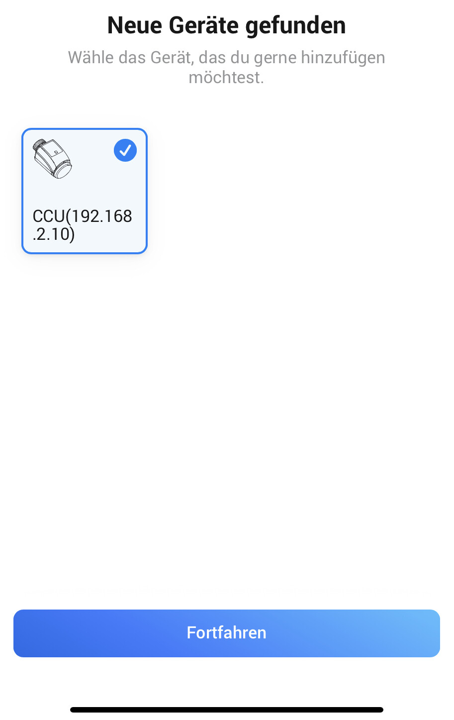

After a few days of trying to add my CCU3 to work with Homey Pro, reading this post and others, I surrender or better try to get help from the community.
Aim is to connect CCU3 via CCU-Jack. So far everything installed, configured according to the infos in this post (Firewall, ports, etc. in CCU), Homey-App (CCU Jack setting, no pw) and I can see my CCU3 in Stored bridges incl. IP-address. IP-address for both homey and CCU3 are permanent.
And now it looks as follows:
  1. I have one HmIP-eTRV-2 connected to CCU3 => working, updating, fine
  2. adding this device via Homey: „New devices found“ => I choose this thermostat (shown with logo of HmiP-eTRV-2, but named CCU (IP-address) => „NEXT“ => „no new devices found“.
That‘s it, that‘s the story.
Any suggestions? I am glad about any help.
Screenshots of the firewall settings, the Zusatzsoftware window on the CCU3 and of the configuration page of the Homey Homematic app (please make the serial number unrecognizable!) might be helpful.
