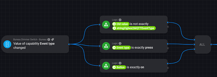

It is a somewhat late reply, but I tried what you said. The State of Entity change card didn’t work for me because all it returned was the date and time. Your second option did work though :D. I created an custom device where I added both the Event Type and the Button, which both are attributes from the entity event.Bureau_dimmer_switch_action.
After I added the entities in the repair view could create an flow that I could create the following flow:
One thing to notice for other people who walk into the same problem: Whenever you restart Zigbee2MQTT the event type cleared and after a short moment pushed again to Home Assistant. Because of that Homey thinks that the entity has changed and triggers the flow. You can bypass this by letting it check that the Old Value is not blank. That way reboots of Zigbee2MQTT are bypassed in the flow and you don’t have flows starting ‘out of random’.
All my dimmer switches are working again as do the lights and motion sensors! This is exactly what I wanted before I started the migration from the Hue Bridge to Zigbee2MQTT.
