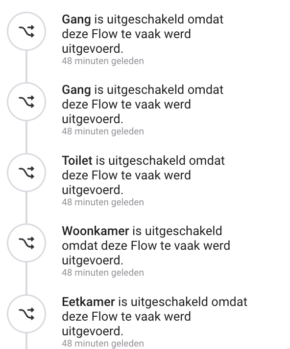

Managed to trigger this when:
  • Restart Home Assistant
  • Turn on/off a bulb 3 times using Hue Wall Switch Module. The event the module triggers is used to turn off/on the bulb. Like in my previous screenshots.
Right when I started restarting for the second time I got like 3/4 notifications per advanced flow from Homey about the flow being turned off because it was triggered too many times. See screenshot:
I can’t reproduce this issue with a HueTap. Every button press in reported once also after/while some HA restarts. Perhaps that’s an issue of the HA integration? Du you have other Hue buttons (dim button) to test with?
If HA is sending so many events, the Homey app can’t do anything.
I can see there is a timestamp inside the event (when it was fired). But the paa doesn’t know if you pressed the button 5x/sec or if that are duplicated HA events.
Can you double check with a HA automation that sends you push messages? Just to be sure it’s caused by HA?
I made a HA automation that sends me a message when a hue_event happens. This sends me nicely 2 messages when I hit the Hue Wall Switch Module:
  • Initial press
  • Short release
I did this a few times and then restarted Home Assistant. As soon as Home Assistant was running again and some of the integrations loaded my flows were all disabled by the Homey.
I did not get any notifications from my HA automation at the moment Homey disabled the flows.
