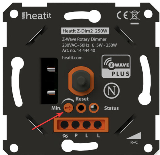

This is done from the potentiometer on the device itself
