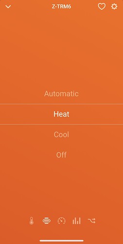

I have some Z-TRM6 thermostats, used with Homey pro.
The app version is 3.6.2
In Homey pro, it is not possible to set the eco mode, not even in the flow.
The available mode is:
Automatic
Heat
Cool
Off

We are indeed missing ECO, this will be added to our integration at a later date.

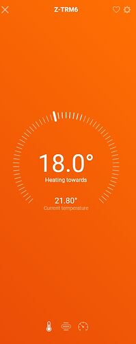

Hello.
Many thanks for your reply.
Good to know that the ECO mode will soon be implemented.
There is nothing wrong with the colors themselves.
The colors show if the thermostat (heater) is heating towards or cooling down/idle towards a set temperature.
The problem is that the TRM6 does not change color corresponding to heating or idle/cooling down, the status text does also not change.
With my TRM2fx, the color turns orange when heating towards the chosen set temperature.
If I decrease the set temperature, the color turns blue and the status text show “cooling down towards”.
With the TRM6, the color is orange and the status text is the same no matter if the thermostat is heating towards a set temperature or cooling down towards a set temperature.
As the photo shows:
this TRM is set to a set temperature at 22 degrees Celsius.
If I decrease the temperature to 18 degrees Celsius, the color should change to the same as the TRM2fx (blue) and the status text should change to “cooling toward” as the TRM2fx does.
This must be a bug?
Thanks.

It’s not all about the color.
The TRM2fx and the TRM6 behave differently.
Example:
Both set to 22 degrees
Then I change the set temperature to 18 degrees on both.
TRM2fx turns blue and display “cooling towards” 18 degrees, meaning cooling/idle against 18 degrees.
TRM6 remains orange and still display “heating towards” 18 degrees, as my photo show.
Since the current temperature is 21.8 degrees, you can’t be “heating towards” 18 degrees.
The correct information should be as the TRM2fx display, “cooling towards”.
This must be a bug in the Heatit app?
I can’t understand that this could be related to Homey, but I could be wrong…
Thanks!

What I see with my TRM-2fx is that the text shows “cooling towards” a given setpoint which is lower than the actual temperature. As in my screenshot, where the actual temperature is 22.4 degrees and the setpoint is 18 degrees.
The 2fx thermostat is not drawing any power at this moment, meaning that is naturally cooling down to the new setpoint.
This is the expected behavior I guess.
My concern is that the 2fx and the TRM 6 behaves differently as mentioned before:
Look at my screenshot in the post above.
2fx and TRM has an actual temperature around 22 degrees, then the setpoint is changed to 18 degrees.
Both stop to heat (no current) and the 2fx show “cooling down towards” 18 degrees.
But the TRM6 still show “heating towards” 18 degrees, which is a misleading information
(The TRM6 does NOT heat at this moment either, it is also naturally cooling down the floor).
I think the way the 2fx integration is made is that is has a workaround for this “Heating Toward, Cooling Toward”.
Both work exactly the same, they both heat, and then stop heating when the temperature goes above the setpoint.
Cooling towards isn’t really a “correct” thing to show either in my opinion, as the 2fx doesn’t cool anything.
We are in discussion with Homey as to how this works and what we can do to fix it.
