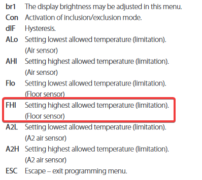

I have several Z-TRM3 in my home. They control electrical heating under wooden floors with a floor sensor. As these floors are heat sensitive (must not exceed 27 degrees) I would like the floor sensors to frequently report the measured temperature to avoid overheating. Right now the frequency is very unstable. Occasionally the reported temperature might not change for 1 hour or longer. Is there any way to adjust this? In the advanced settings for the unit I have set Temperature report interval to 60 (S), and the temperature report threshold to 1 (C).
What do you need the frequent reporting for? Are you using flows to control the maximum temperature instead of the AF mode on the thermostat itself?
I use the “floor mode” on the thermostat to regulate the heating in the floor. If the report frequency is “too slow”, this could lead to the floors overheating above the threshold of 27c. How often the floor sensor reports temperature appears a bit random. Is it possible to adjust the frequency?
The thermostat has a built-in max limiter for the different sensors.
The report interval does not have anything to do with this function as it is controlled internally in the device.

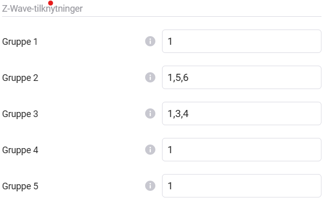

Sorry for the late reply, but I needed to change the Homey language to English before replying to make sure I don’t do any translation mistakes when I reply regarding the association groups. And in order to do that, I needed to restart Homey. And of course I got an update from the troublesome Z-TRM3 immediately after reboot.
But it turns out that update was a one off. I have not gotten any further updates since than
I have very little knowledge about z-wave association groups, but the advanced settings tells me they are all the same:
Bathroom1 = Group 1 1.1
Bathroom2 = Group 1 1.1
Hall = Group 1 1.1
Livingroom = Group 1 1.1
It’s the Livingroom one that is not working properly. This is the one closest to the Homey box. Like 3 m away with free line of sight.
Should I try to change any of these settings? To what?
