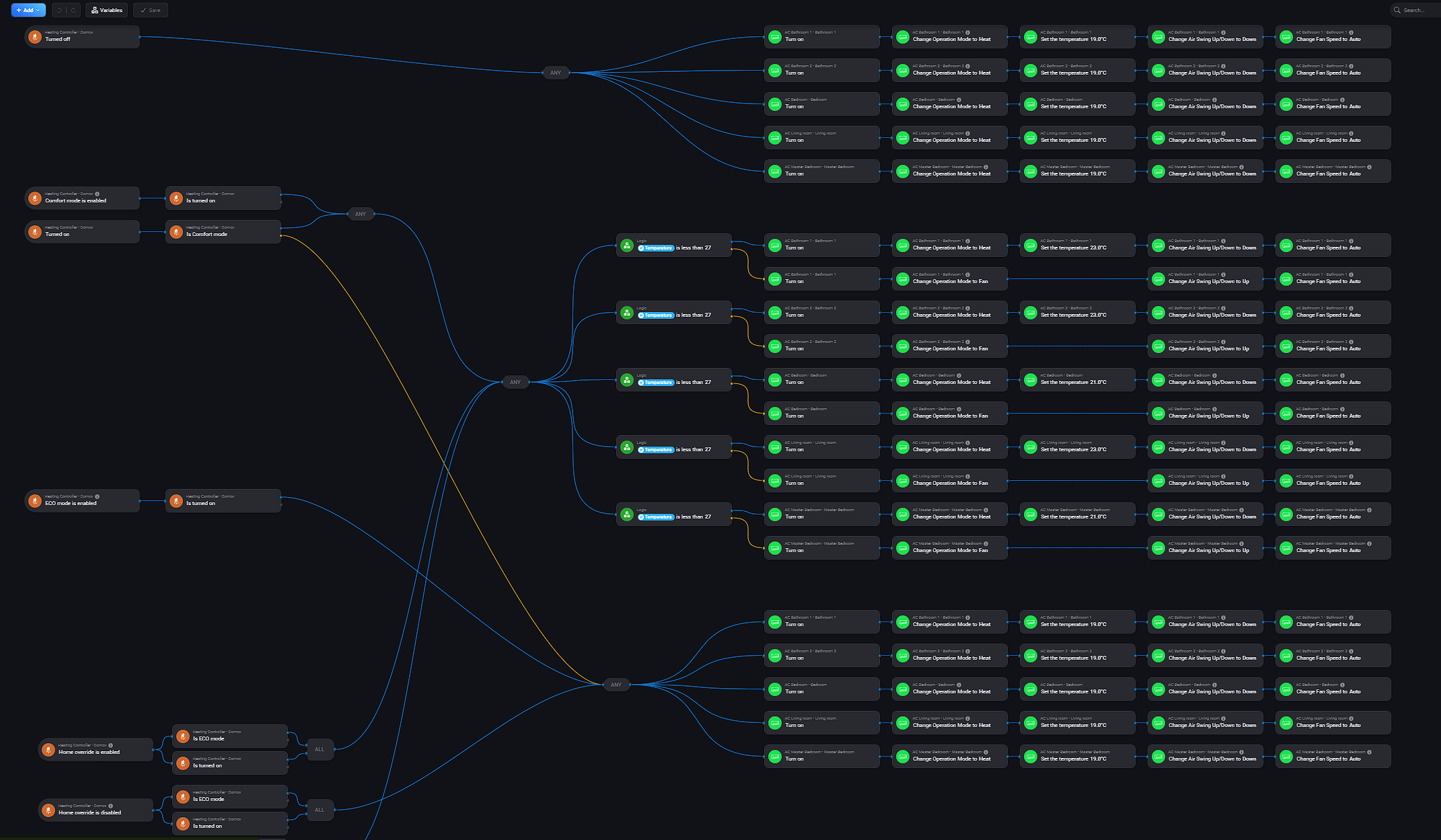

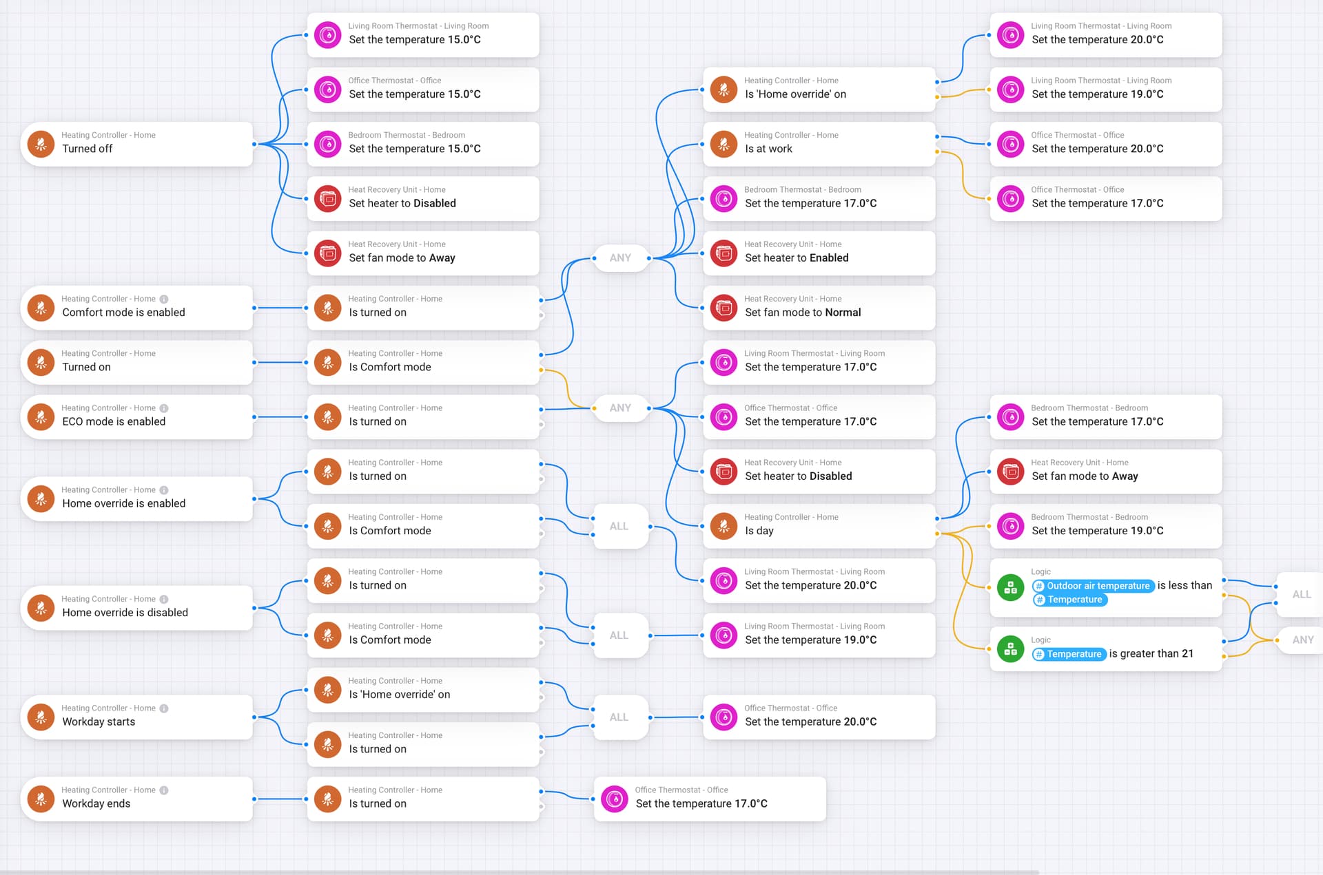

here’s my current heating plan. As you can see, I’ve currently set it up so that every room is only heated when needed, and preheated only when I’m about to come home. It’s a basic schedule and current utility prices are yet irrelevant.
They are not yet in it, because I’m still experimenting on how, if and when it makes sense to do preheating based on utility prices. Factoring these in adds a whole other level of complexity.
