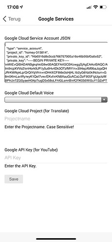

Did read this, but even after I have added the JSON (checked by JSONLint - The JSON Validator),
and pushed the Save button.
there is still no list of voices visible, only a black bar:
What have I done wrong?
Try a restart of the Google Service App?
Is your JSON still saved?
Dit (again) a restart, this time I got a message to goto :
https://console.developers.google.com/apis/api/texttospeech.googleapis.com/overview?project=99xxxxxxxxxx
I had to do an ‘Enable’ and something with pricing, after that, the Voices are shown.
Thanks for the help.

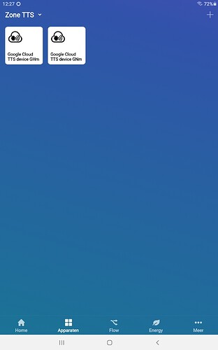

I have created separate Google Cloud TTS devices intended to use for each physical device.
I have successfully made it to do TTS for one om my Google Home devices, but I can’t figure out how to make my other devices run TTS. They simply don’t play. Here is one example:
When testing, it simply does nothing - just hangs there…
Some times I receive this message:
What am I doing wrong in order to get TTS on more than one device?
Nevermind - rebooted the network (wifi and router) and it started to work. I think it was a general problem with Chromecast on the network.

Hello There,
Please tell me what i do wrong…
I put in the file all wel but it is not showing default languages
I heave 2 google minis
If you have pressed save, and no voices are visible, then probably something went wrong with the billing acception.
