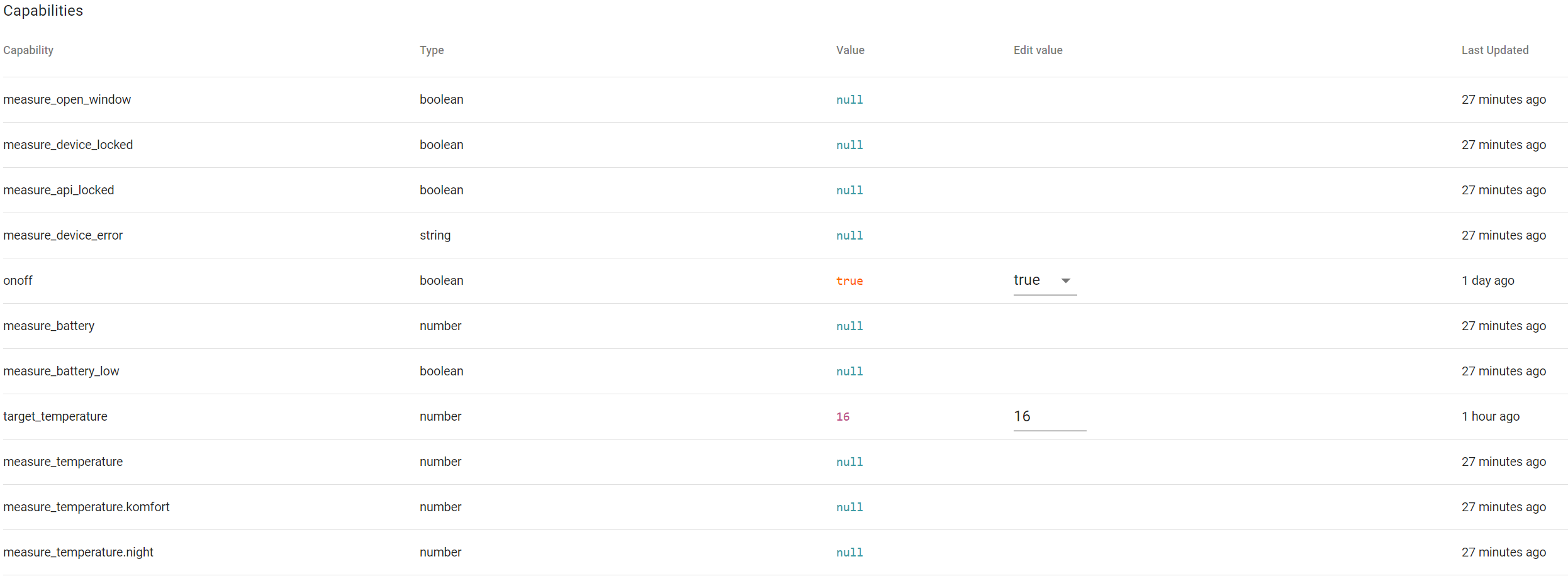

Unfortunately, most properties are null for eurotronic comet (version 03.68) and Fritz Dect 301 (version 04.89).
I am using this app for my fritz Box with the Fritz 301 thermostat. The thermostat is working fine with homey, only I have no battery level and return temperature in the app visible. Has anybody an idea how to solve this.
I found the problem. You have to set polling active in the configuration of the app
