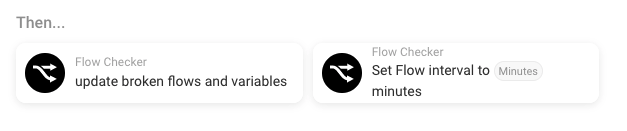

New app update (test: 1.6.1.):
  • NEW: Add action flow card - Update flows and variables (@Henk_Renting)
  • NEW: Add action flow card - Set interval (@Peter_Kawa)
Damn, you’re fast…
Thx!
I can’t spend an evening with my dad and in the meantime there’re even more features implemented. :heart_eyes: Thank you so much Martijn! If you were a woman I’d kiss you :sweat_smile::sweat_smile:
I’ll check the new features out in a minute.
Edit:
Works like a charm, and THX for the flow with links overview! (And for borrowing your icon :grin:)
