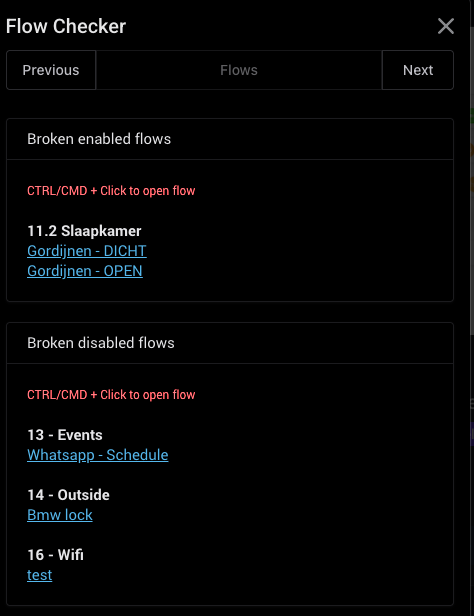

New app update (:orange_square: TEST: 1.34.1.):
Changelog:
NEW:
1. NEW: update Homey API
2. NEW: update UI
3. NEW: differntiate between enabled broken flows and disabled broken flows
FIXES:
1. NEW: add Homey Logic overview
2. NEW: show variables per flow
3. FIX: isBroken
4. FIX: revert interval decrease
5. FIX: Better Logic variables mapping caused a issue
6. FIX: enhance flow token mappings
Explanation:
Show all Flows which have variables in them. Also shown which variables
Show all Logic variables and which flows are using them. If there’s no flow the variable is unused

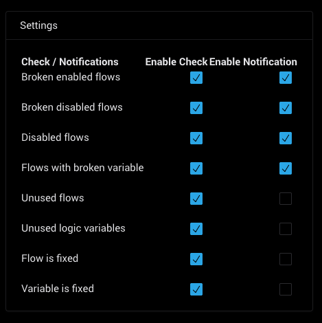

Option to disable checks all together (keep overview clean) or disable notifications
Differentiation between disabled broken flows and enabled broken flows
:collision: If you find any issues, send a diagnostic report
:warning: Note: Before sending a report make sure to reproduce the issue so the issue will be visible in the report
  1. :mobile_phone: Via Homey Mobile app:
    More - apps - Flow Checker - settings wheel right top - send diagnostic report (add your email to the description)
  2. :laptop: Via Homey Webapp:
    Settings wheel bottom left - Select Flow Checker - Click on send diagnostic report (add your email to the description)
You can install this version by clicking the link (version number) above and press install
:fast_reverse_button: Don’t want to be part of a test version? Install the live version → Flow Checker | Homey

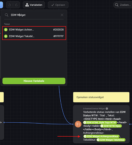

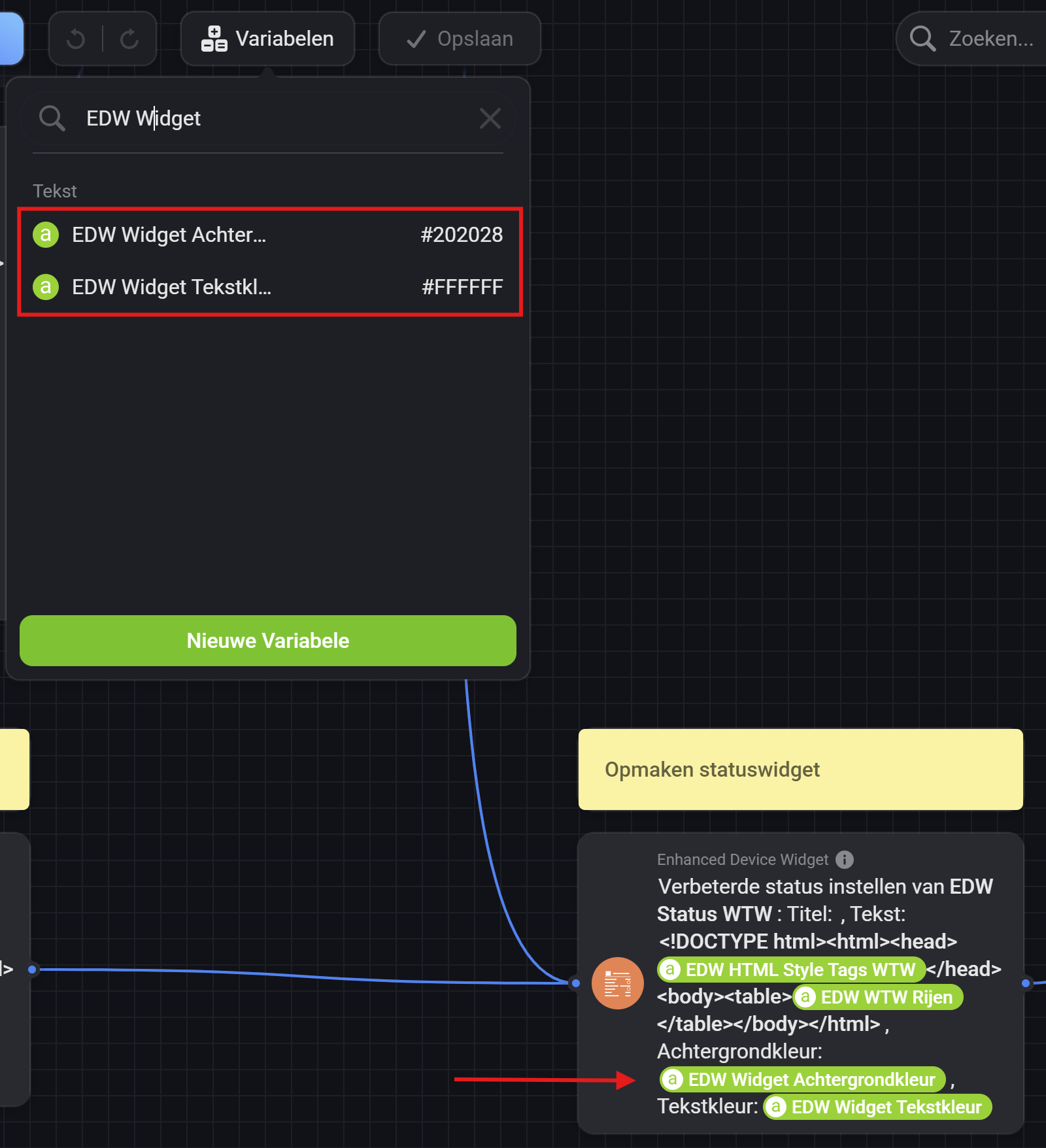

Hi Martijn, I have a question related to the latest test version (1.34.1).
It reports unused logic variables. In my case the following two:
However both are used in several flows. I checked whether I have duplicate variables with the same name, but that is not the case:
Any idea why these variables are reported as unused?

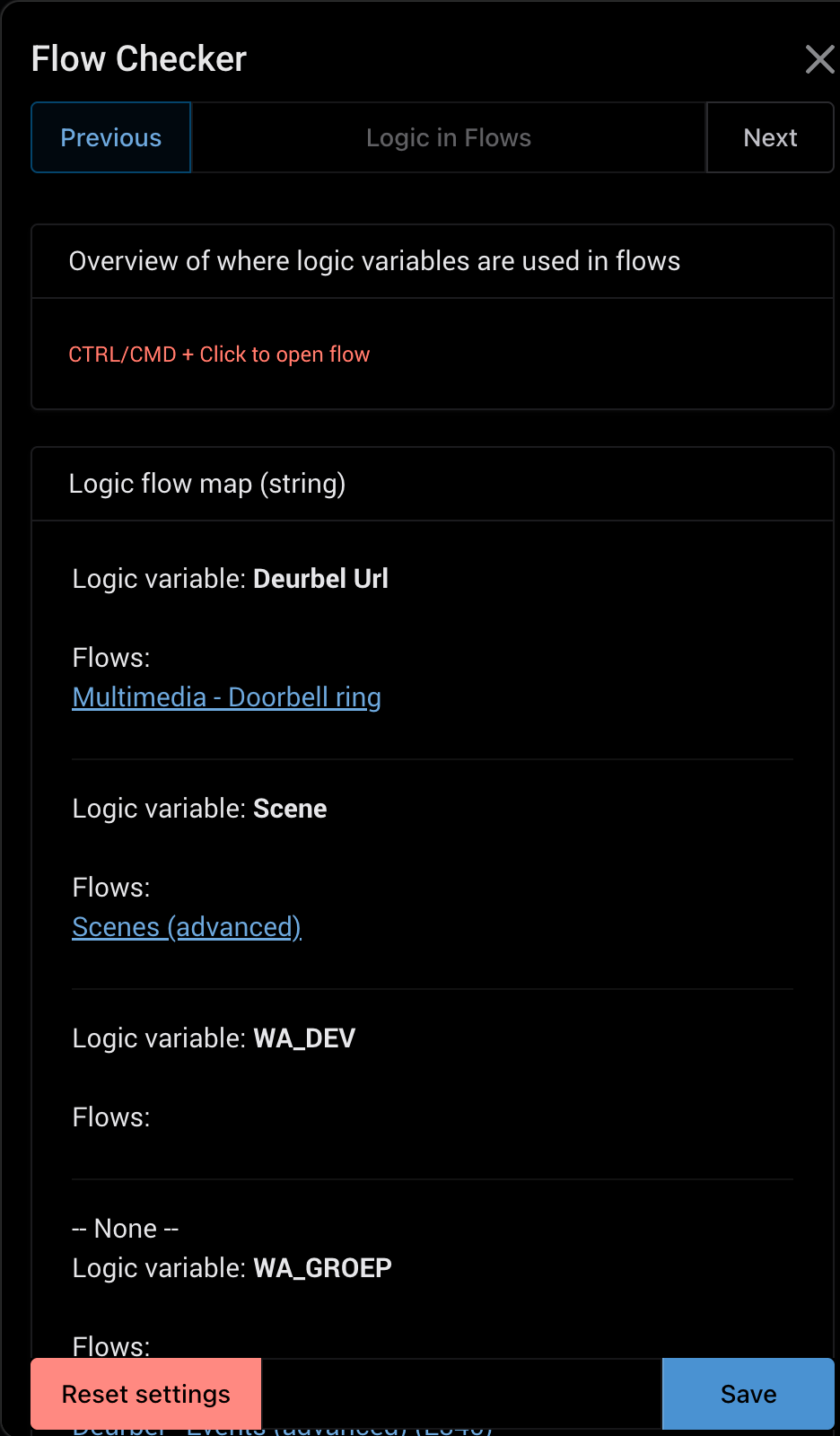

@SunBeech can you check the new page? It should show where your variables are used
And no I have no idea. Can’t do much with a screenshot. Please follow the instructions as mentioned in the release post
Also do you see the same issue with the live version?
I checked the new pages in Flow Checker for the flow in my screenshot
  • The page ‘Flow with Variables’ does not report the two logic variables, although they are used in the flowcard from the Enhanced Device Capabilities app (shown in my prior screenshot)
  • The page ‘Logic in Flows’ indicates for both logic variables that they are not used in a flow:
I am using these two variables in several flows, but only in one specific flow card included in my earlier screenshot: the Set Enhanced Status-card from the Enhanced Device Capabilities app:
I reverted back to the last available live version v1.30.3: same results.
I have sent you a diagnostic report from both versions:
  • v1.30.3 (live): b0ab7a15-5af1-4324-b4c0-e1ae5f3eecb5
  • v1.34.1 (test): 342ec5fa-0a2f-4837-b15d-e507622fb502
Let me know how I can help you track down this matter / whether you want me to provide additional information. Thanks for your time!
