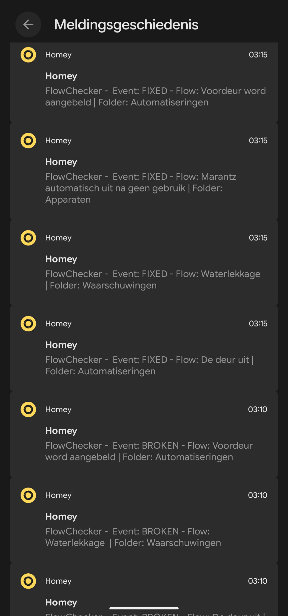

Since the update from today I constantly get errors in my timeline that flows are broken and after that a few min later that flows are fixed….. how is this possible? I already restarted my Homey Pro and the app multiple times. I created a diagnostic report as well

Goodmorning @martijnpoppen unfortunately it didn’t solve the issue. When I woke up I had 49 notifications about broken and fixed flows, see screenshot (partial,since I clicked away the banner)
Flows do work however, so it is misleading that they are broken

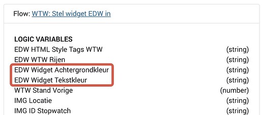

Hi Martijn,
Since the latest update, Homey crashes when I want to edit a variable in a flow. It shows an error page with the following error:
An error occured
TypeError: can’t access property “toLowerCase”, B.title is null
If I disable the Flow Checker app the problem doesn’t occur. The Diagnostic Report is:
753657a0-b2ee-4946-ba51-03609a34a1f7
