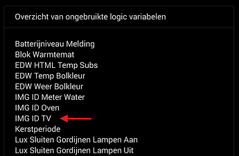

Hi @martijnpoppen, You fixed the issue related to multiples variables in a flow card in a prior version that resulted in 2 variables being reported as unused (in my case). After this latest test version (1.35.0), FlowChecker now reports that I have 25 unused variables, while all are in use.
I created the following log: 8019416e-ac89-42dc-a6cf-3801b5e05de3
@SunBeech thanks will check, had to take some actions to prevent memory overflow for users with lots of variables.
Will check where this went wrong :smiley:
@SunBeech can you share the JSON of one of the flows which has these variables? So I can use that to reproduce
Yes, no problem. The following flow contains the IMG ID TV variable, that FlowChecker reports as not in use.
JSON of flow

@SunBeech can you check the latest TEST version ? :slight_smile:
Yes! You fixed it :grinning_face:. FlowChecker now reports 0 unused variables again, and reports the example variable to be linked to the flow for which I shared the JSON:
@SunBeech Nice! Also app should be lower on memory now :crossed_fingers:
That’s a nice extra bonus :wink:.
Thanks for the quick fix!
