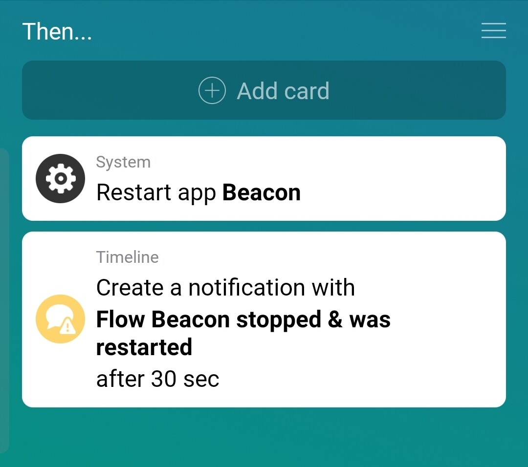

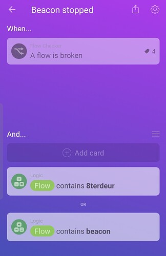

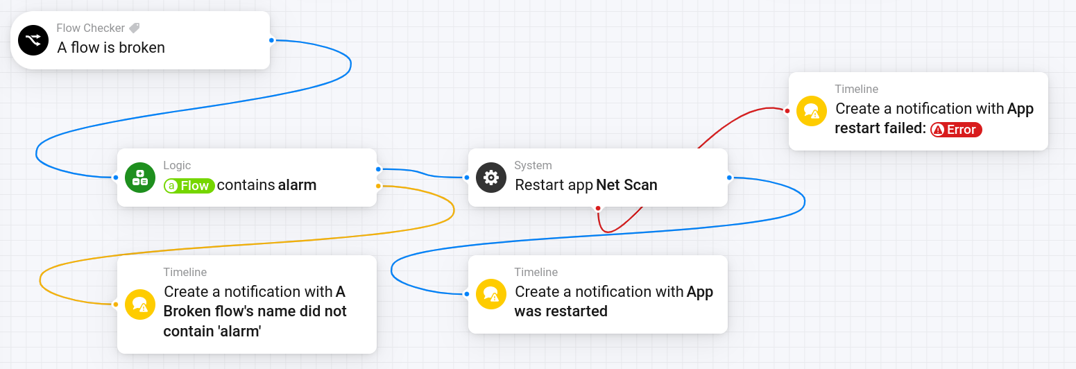

This one works for me:
Can you try something like this:
Hai Peter, Thanks for your answer. You example is nearly the same as my flow. My flow works when Eufy app crashed and flows are broken. But it does not work when the app is paused by Homey due to too high use of RAM (according to answer of Athom why Eufy app is paused). I cannot reproduce this issue of course.
Maybe this issue occurs because I use advanced flows and Flow checker cannot handle this. I created today also a simple normal flow. I ll wait until the Eufy Seceurity app will be paused by Homey and let us see what will happen.

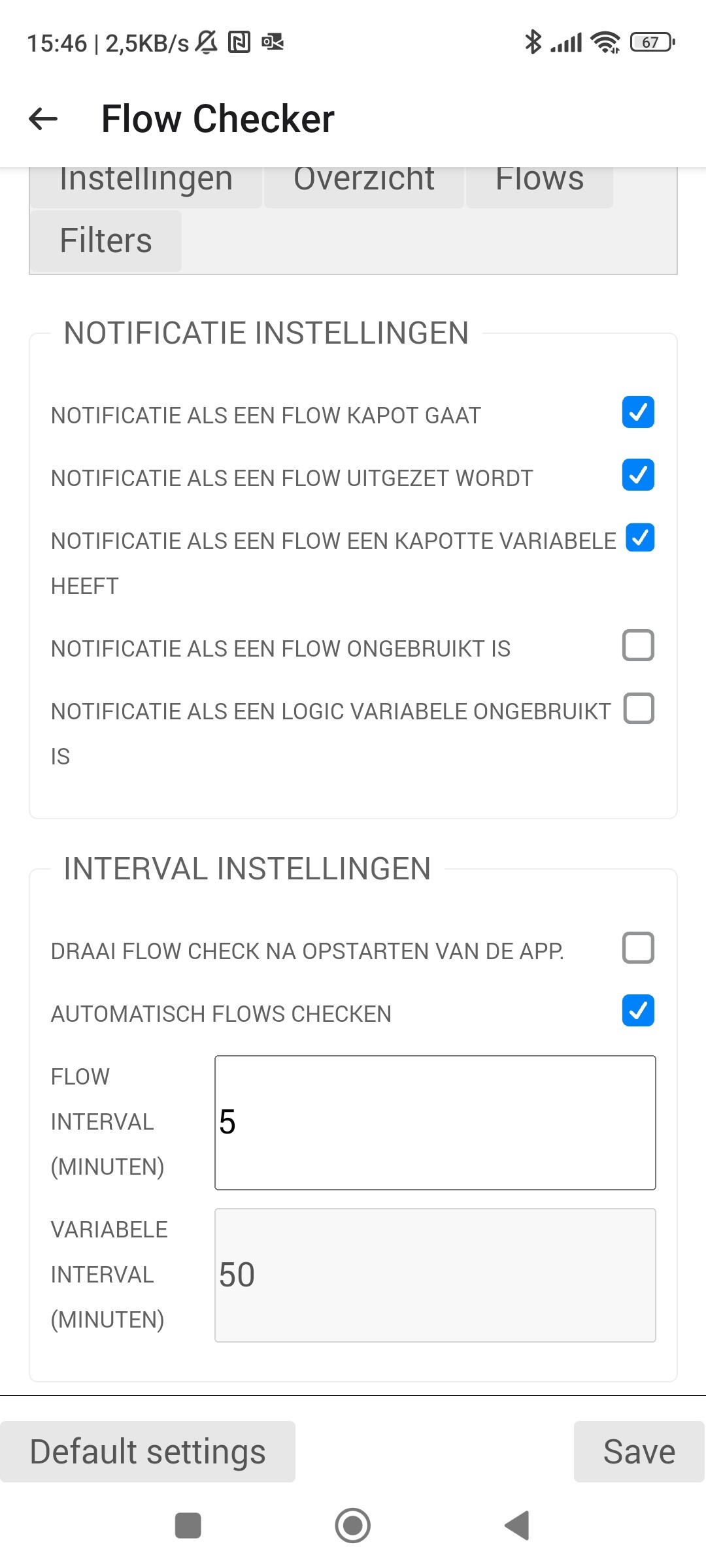

Hey @Erik_Batenburg
Can you share a screenshot of the FlowChecker settings?
