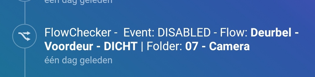

I’ve a small “issue”:
after deleting a broken or a disabled flow, a notification is generated, like “Flow X became active”
It’s not needed and somewhat confusing imho.
So if you have an idea to solve it, :beers:
And if not, no problemo :grin:
Cheers, Peter
Hey @Peter_Kawa ,
Probably you made that notification :stuck_out_tongue:
Because the app is in english only.
There’s a flow card for when a flow became active again, but no notification.
However your point is valid. That flowcard shouldn’t be triggered if the flow gets deleted. Not sure if that’s easy to fix though
Ah! You’re right :grin:
Found it:
But don’t break your head over it. It’s just a minor itch!
