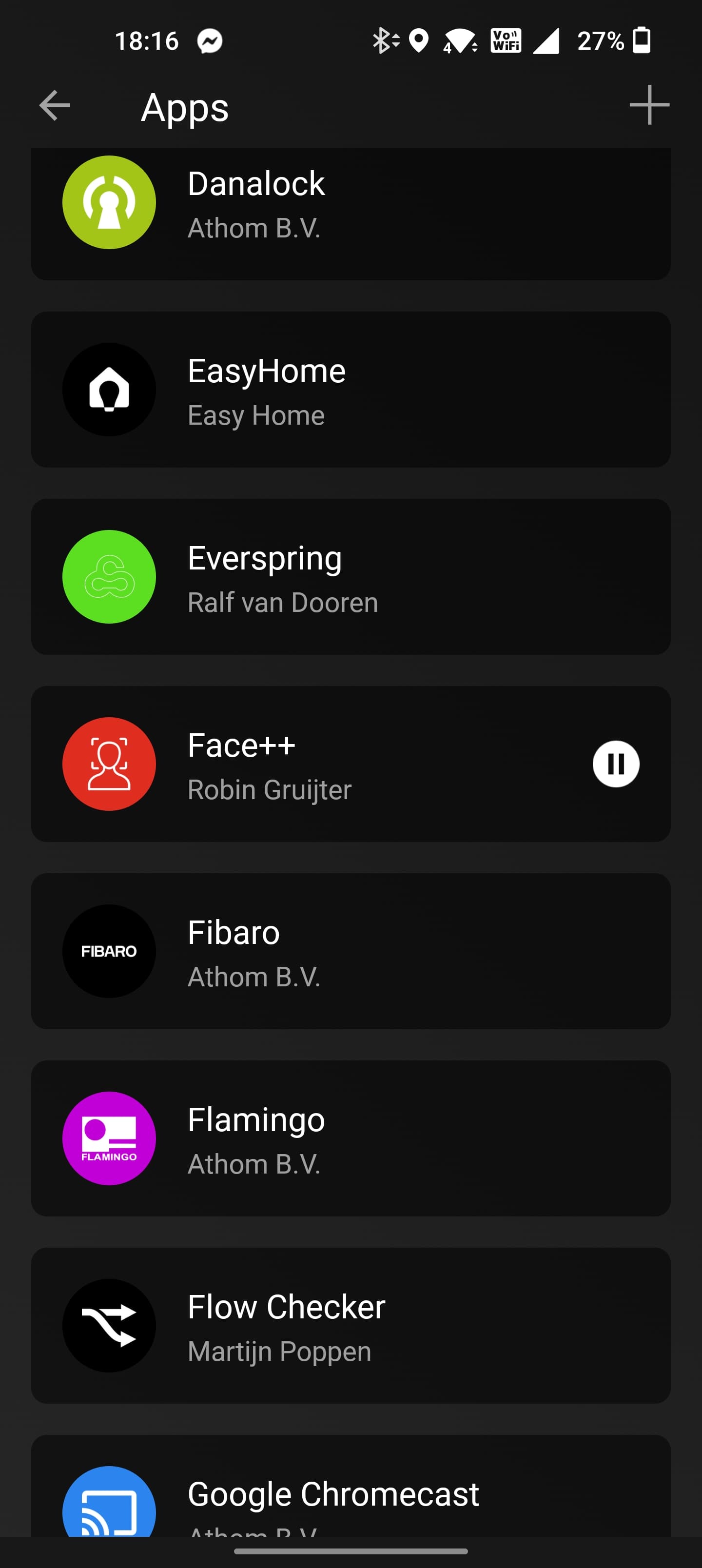

My Face++ app keeps crashing(or pausing) when being used.
This is a Homey Pro
I made a diagnostics report:
4c18eb75-632b-437e-a32f-7b48fb46b58f
This was not an issue at first during testing, but after i mounted the camera outside.
There is absolutely no information in the crash report:

But anyhow, I want to upgrade the Face++ app to SDK3 somewhere in the next few months. So when I have a lot of spare time I will rewrite the entire app. That means I will not do any maintenance on the code now.
@Gruijter Do you think the upgrade will fix the issue?
I dont think so. Nothing changed in the app, so your issue must be something else. My guess would be account related. Try setting up a new account with face++.
