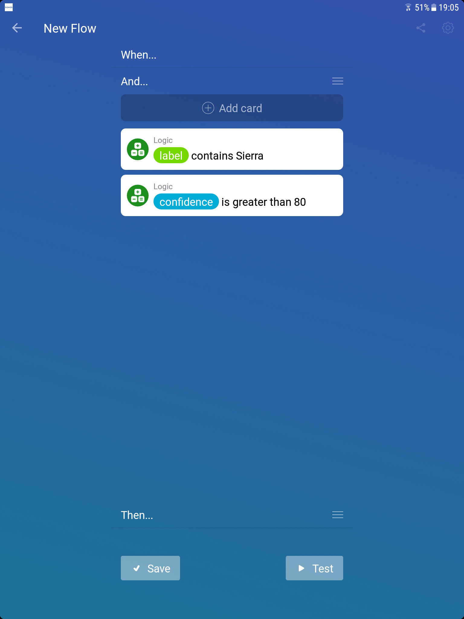

Ah I see. I tried this and it still giving me the same thing in logs
The logs just show that a face was detected, it doesnt log what happens to flows. However, if a face is detected, the flow will also be triggered (the IF part of the flow). But with the AND conditions the THEN will only be executed if the conditions are met.
I think I got it. There seems to be some sort of cool down on my cameras motion detection or something and the app doesn’t recognize me for more than 78% confidence, I lowered it to 75 and it seems to be working now
