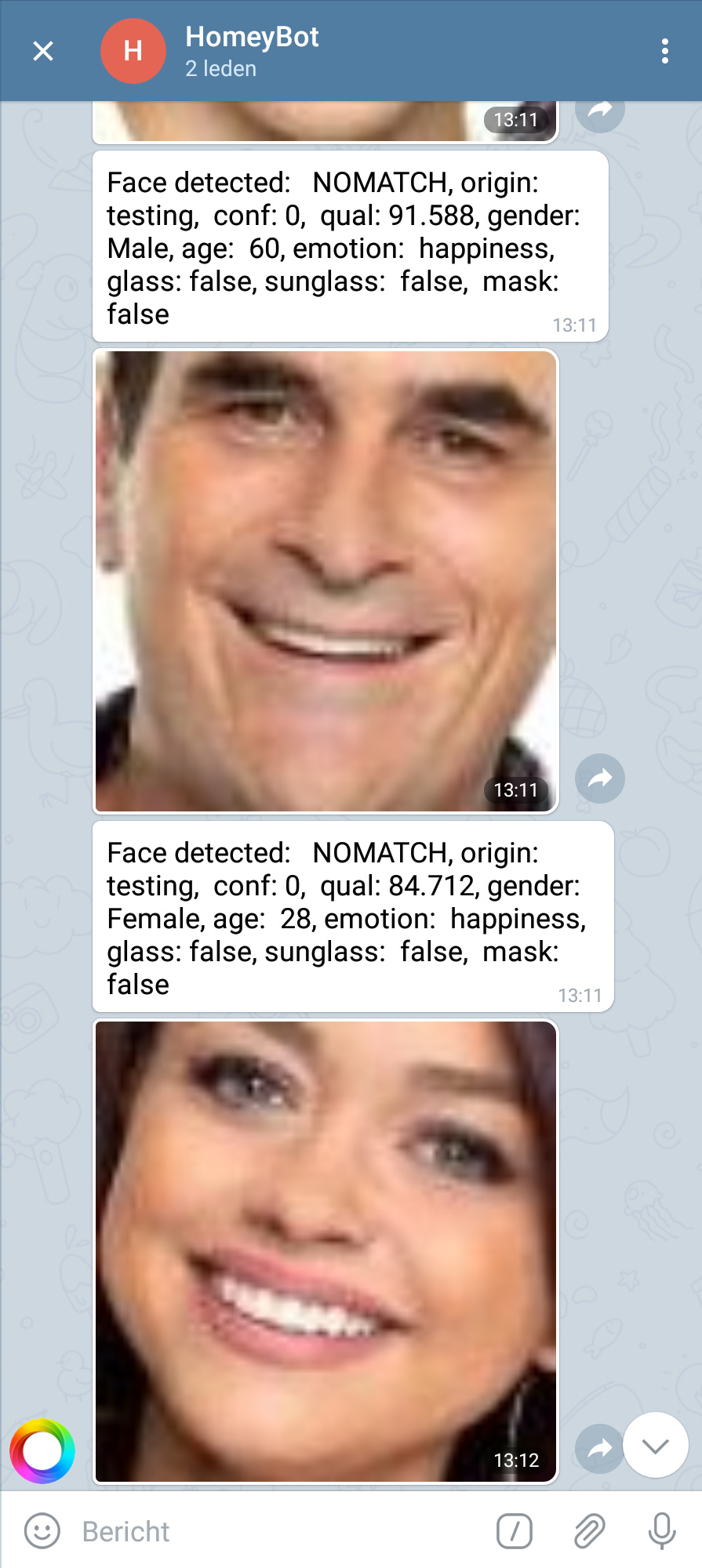

What is your use case for having the last detected face available in Homey? I send all snapshots to telegram, so there I actually have all snapshots that were taken for the last few days, including timestamps and source id.
I’ve not used telegram so will look into that.
It is just so I can have somewhere to see the last detected face as at the moment once I dismiss the notification from my phone the face has gone.
Telegram is your answer then :wink:
