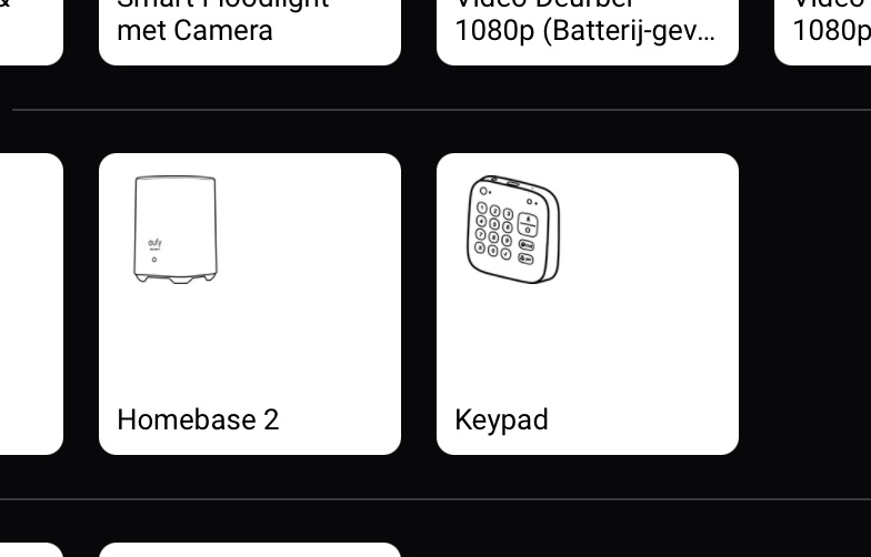

When I want to add my keypad, I get the following message.
Is this normal? I have app version 2.2.5 on my Homey.
@RobbertV : no i dont think the status is changed in my homey homebase. When i press on the homebase icon and go to the first screen where you can see the status, the selection bar is on the blank top row. So i dont think homey is getting the settings from my homey base.
I thought that this might have been due to the different language settings (homey-nl, Eufy-eng) but i tested with the same languages and this did not fix it.
@martijnpoppen the keypad works with the home base in the eufy eco system. Ive been using these together successfully.
@J_Pouwels Yes this is normal. otherwise you won’t see that message. :wink: (the message is quite clear.)
