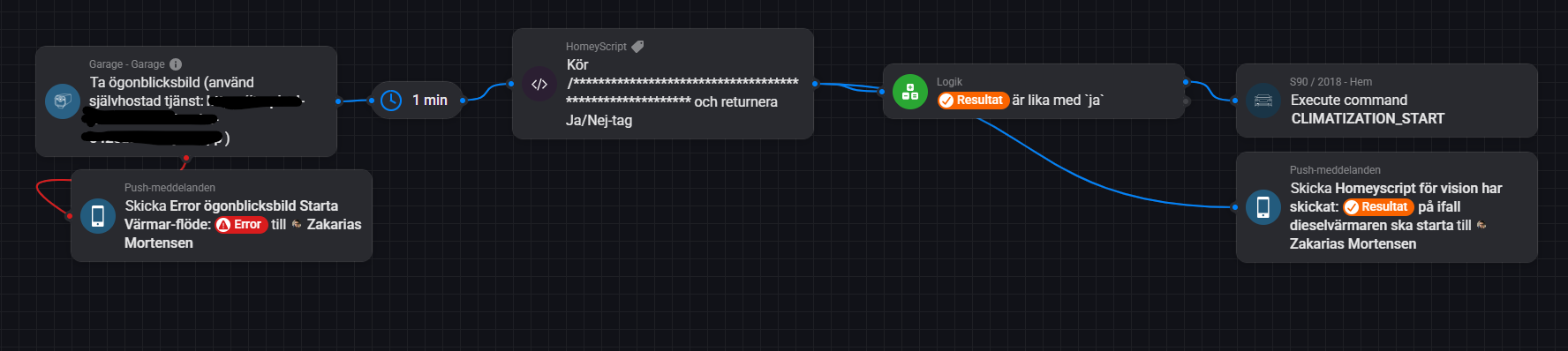

I’ve tried to use Homey script to dynamically get the image URL, but no luck yet. I’ve tried homey.images.getImage(), but seems lite it is still not working correctly (source). And to try to pass the snapshot tag from flow does not work either as the scripts flow card only support number and string afaik. So the only way seems to be via fetch, but i’m not entirely sure how that works, does anyone have a script/flow example of their snapshot setups?

Well, essentially this is how one part of the flow i wanna fix looks like:
The problem here is that with a Homey script, there is no way to grab the snapshot image tag. If i try the Homeyscript tag which includes an argument it does not accept images (so I’ve not figured out any other way to grab the snapshot other than getting the URL).
Here is my script if that is of interest (sorry for the Swedish):

@Zakarias_Mortensen I checked with athom but they said this is how it is supposed to work so the image url should change every time
Ah, too bad. :face_exhaling:
I’ll let you know if i come up with a solution. Cheers for the help.
