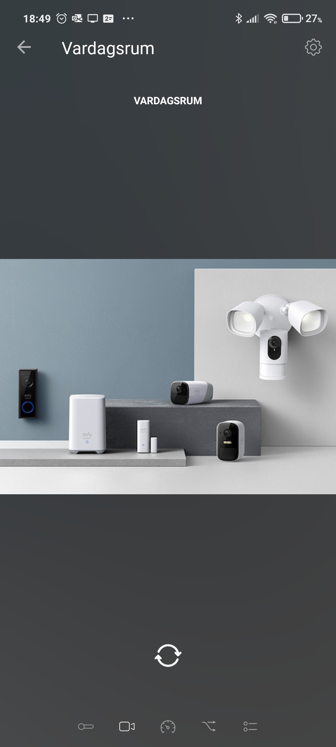

I have a beginner questions, why can’t I see anything on my pro 2 cam
Hi @Tb1 ,
This image only updates when you got an event like motion or doorbell press.
I would suggest to restart the Eufy-Homey app, because sometimes the images are not registered correct.
