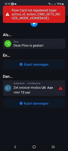

Since today (new version?) my script to snooze motion alarm fails.
“SETS_NOOZE_MODE” Typo?
@CoonHouse please send a diagnostic report
Edit: I see, this was due to the translation by AI :frowning:
Will go trough all the files again
@CoonHouse fixed in 3.29.4 :slight_smile:
