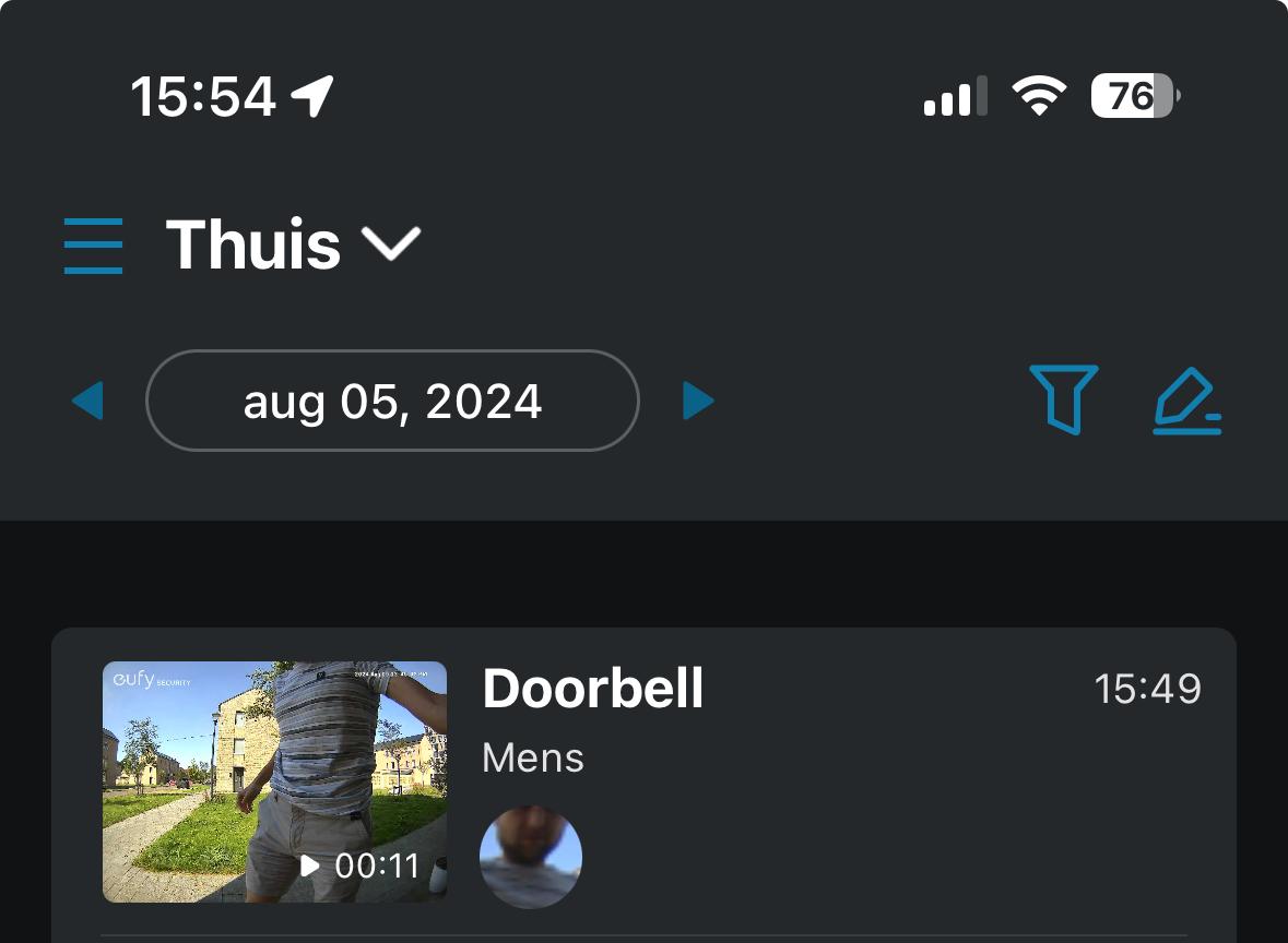

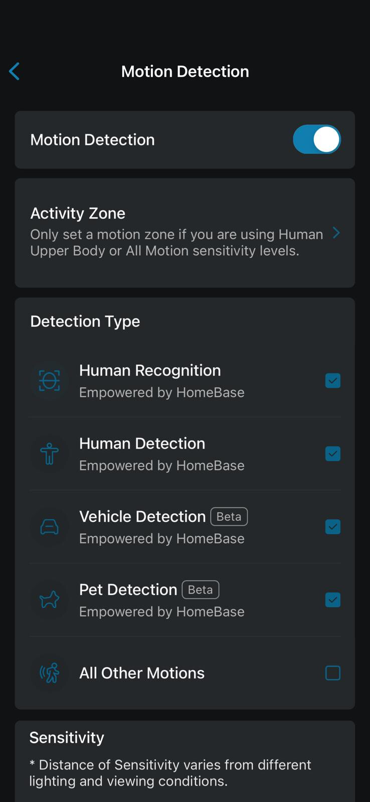

@Abdullah_Rasool can you verify your doorbell has all notifications enabled?
Eufy - doorbell - settings - notification:
Eufy - doorbell - settings - motion detection:
Enabling one of the mobile notifications and turning it off resolved it. Thanks a lot Martijn!

Make sure to keep the push notifications enabled, that’s (unfortunately) the only way to get them in Homey.
Edit: I extended the FAQ a bit so it is better findable in the future :smiley: FAQ Q1: [APP][Pro] Eufy Security - #4 by martijnpoppen - Apps - Homey Community Forum
I had one of them enabled (the one for doorbell - not for motion). But just enabling the second one (which I don’t need) fixed it. Afterwards, I could turn the second one off again and it remained working.

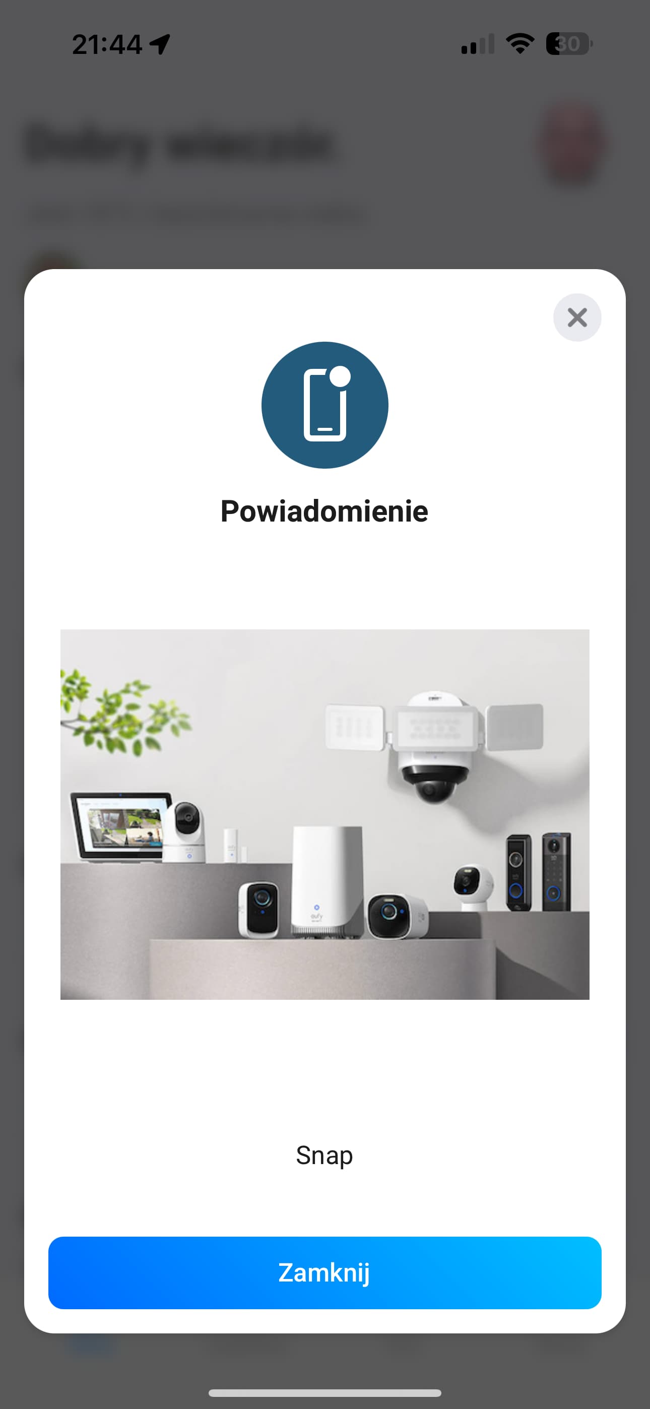

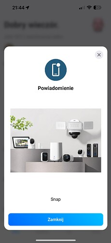

I still have a problem with my E340.
I live on a busy street, someone walks by the door every now and then and I can’t set the notification to receive a push with a photo of the person pressing the doorbell.
I wanted to use Snapshot, but regardless of what I do, I always get the photo below.
Could you please help me?

I would suggest a Homey restart, However i don’t think that will solve the problem. You’re using your E340 in standalone mode. When it;s in standalone it’s doing a lot more battery saving than when it’s connected to a HB3.
So because of the battery saving there’s a mismatch in the timing and the stream is not long enough to take a snapshot from.
This might work with a self hosted snapshot service FAQ Q13 but also not sure about that.
