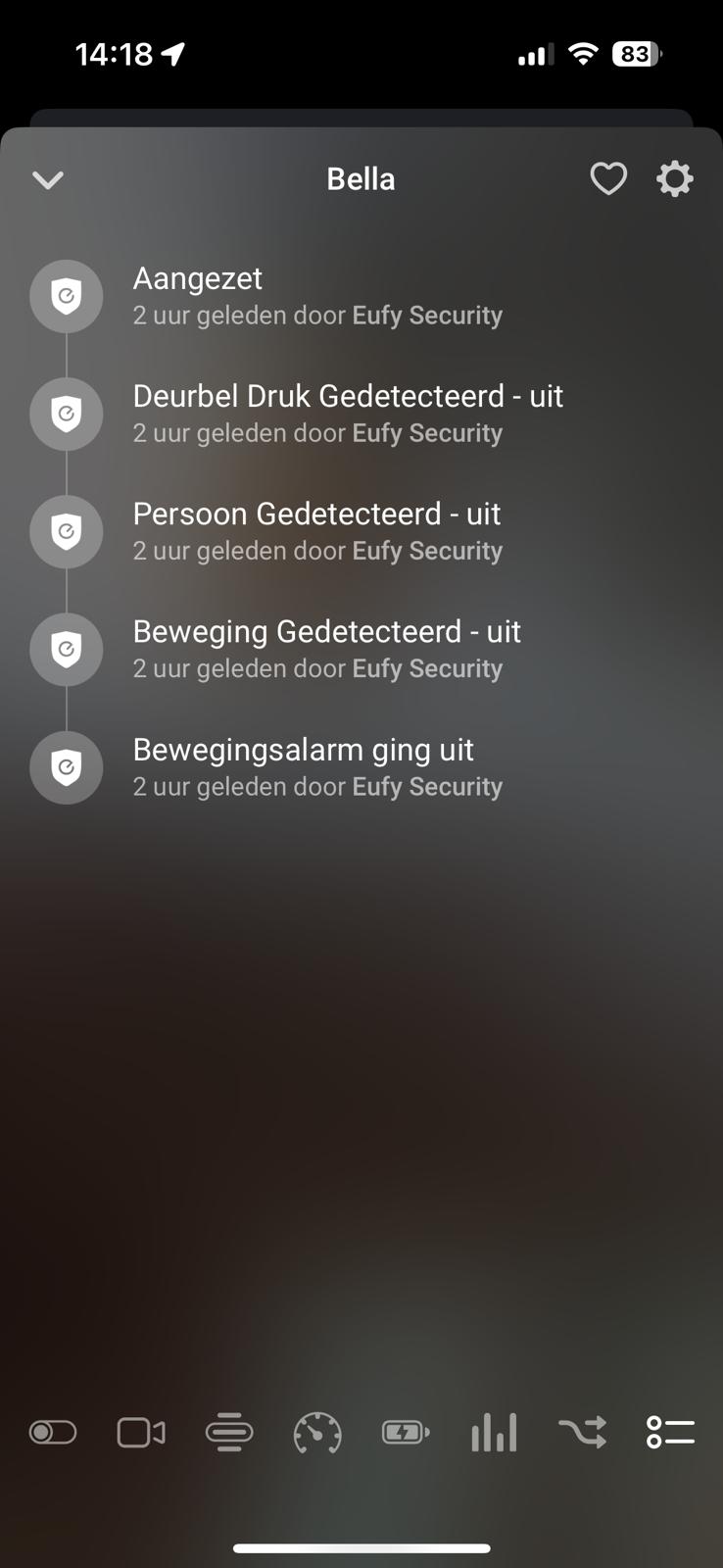

I have an issue recently with my Eufy Battery 1080P/2K doorbell where Homey does not receive doorbell press events/notifications even though it is set up in the Official Eufy app. I have removed the devices/Eufy app in Homey. Additionally, I have also removed/re-installed the doorbell and homebase in the Eufy app but without success.
Please find below printscreens of the current situation. Do you have an idea what I can do to resolve this?

I have the feeling it is because of the Deurbel Druk Gedetecteerd - uit indicator from Eufy Security. But I have no idea how to turn it back on:
@Abdullah_Rasool
The Uit indicator is just a device timeline which show what happened when. So that fist turn off is because fo the new device.
Looks like you enabled your notifications already.
