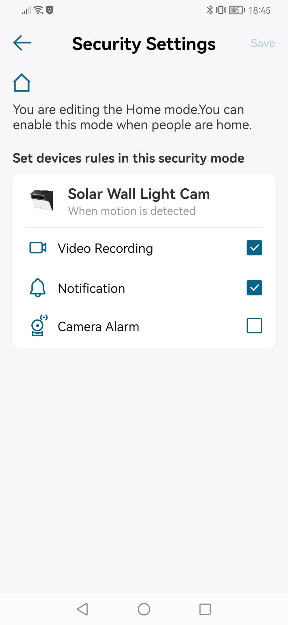

@martijnpoppen it was previously enabled. But I re-enabled it. I now have over 9 push notifications from Eufy within 4 minutes for movement. But zero coming from Homey. It’s just not coming through for some reason.
Nothing is registered from the camera inside Homey. Temperature remains empty, no snapshots or event images, no motion detected, nothing.

@martijnpoppen I’ve completely deleted the Homey Eufy Security app, and reinstalled it. Rebuild the basic flow:
Walked in front of the camera, got a “Motion detected” push notification from the phone-app, but nothing in Homey.
